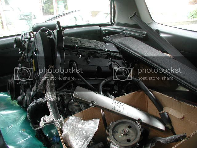

I picked up a 92 Prelude Si with a blown up h23a engine. Same day I picked that up, I found an h22a for sale locally as well. The swap has been a much bigger then bitch then any b-series swap, but hopefully this should be fun now that its finished.

Here is where the engine started...
And this is where its at today...
When I finally got it started (took awhile because the battery was dead and I had to hook it up to a tiny car charger) it threw a code. Turns out it was 41, so something with the 02 sensor. I will check it out later. Things I have still to do are,

how is this swap a bitch...its seriously gotta be one of the easiest swaps of any honda out there. I did one two weeks ago..I made a common rookie mistake, and had it fixed in about 10 seconds. EGR and VSS have the same connector....as i said, quick fix. engine's running strong. makes me wish mine ran that well.

Too bad you couldn't rip out that 8lbs flywheel while you had the engine out. That shit is wwaaayyyy too light for a stock motor .... trust me, it'll be the death of your tranny.
