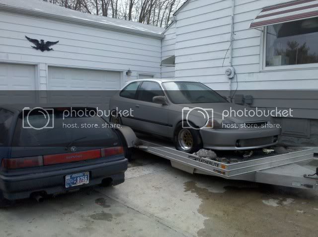

How it looked the day i brought it home from Chicago.

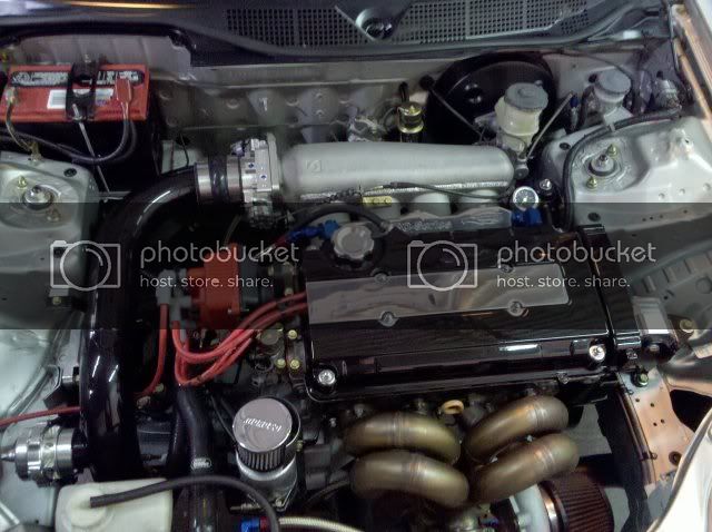

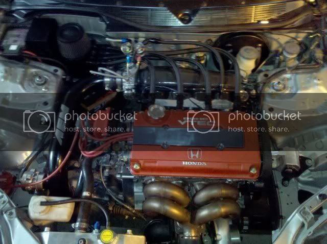

The Engine Bay

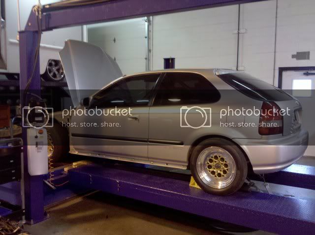

First thing i did was dyno it at work and see if it really made 700hp like they said it did well it only put down 640whp.

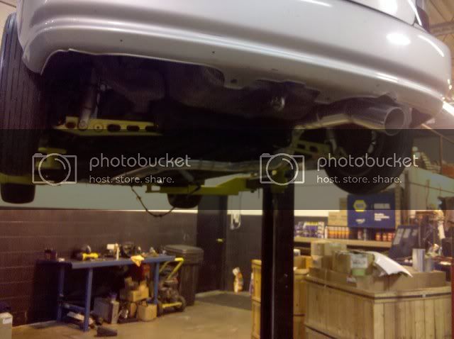

First thing i did was make a 4in Aluminum exhaust for it it was open down pipe when i got it
