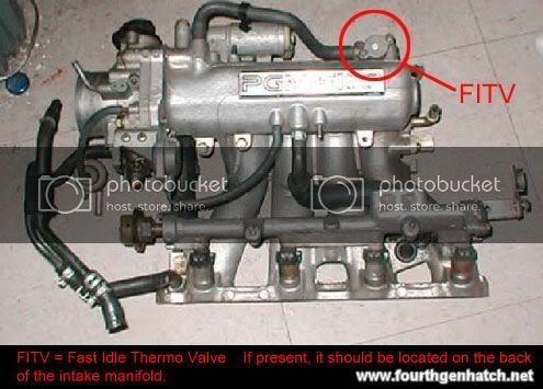

i was wondering if i need this and if yes what wires from my harness go to it?
assuming you're referring to a d16a6 then you don't have a fitv. you have an iacv though, and yes you need it.
well the guy on fourth gen hatch calls it a FITV i have one on my manifold . ?????.
well he is a dumb shit then. this is a fitv. if your had been equipped with one it would be located beneath the throttle body
that is a purge control solenoid valve. its only needed for ultra cold temperatures and its really not that necessary. assuming you don't live like in the arctic.
