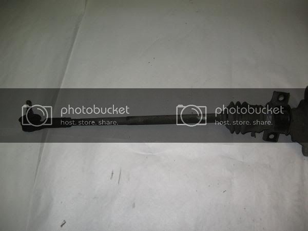

    Aren't you a member on pp.com as well? Anyways, if you know anything about your 4WS then you would know that the only boots he is talking about is the boots on the rear steering rack, let me show you a picture:
    Its that boot you see between the tie rod and ther main housing. But he could be also talking about the front rack as well, so verify that.
