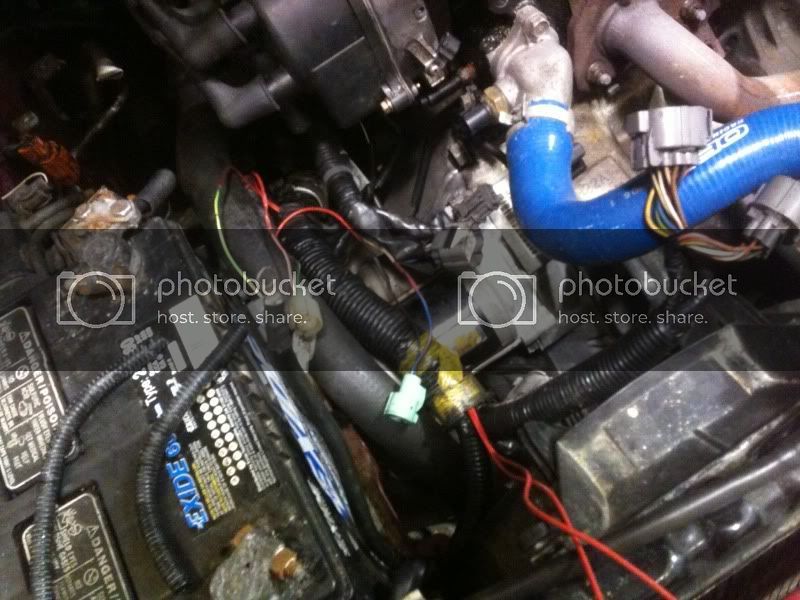

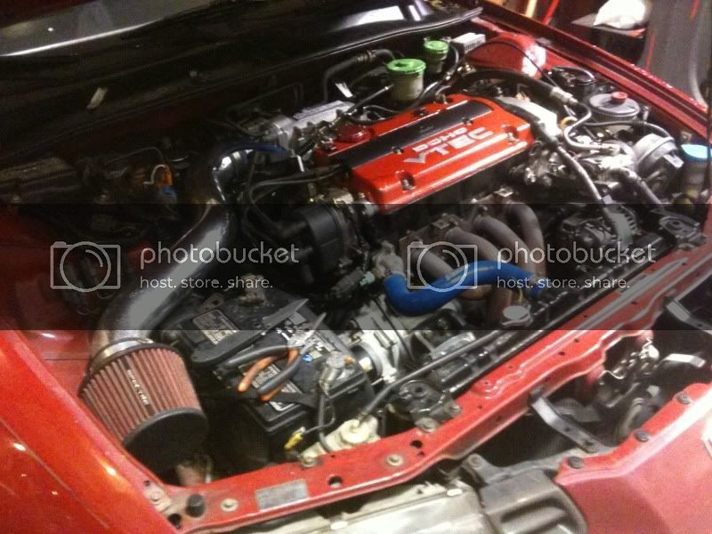

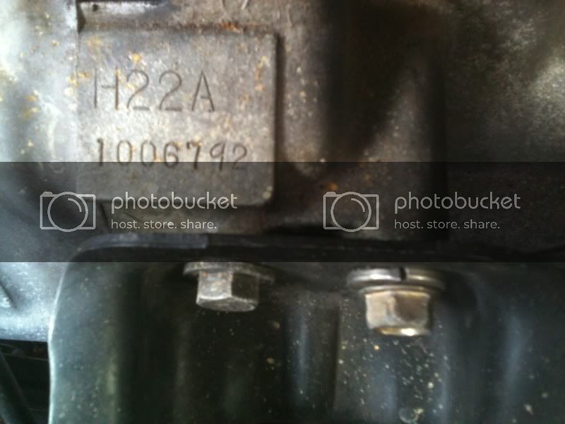

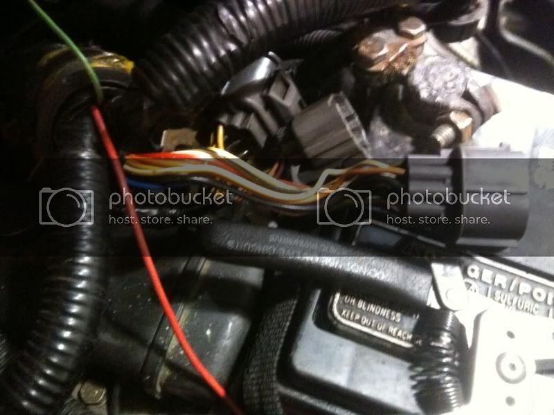

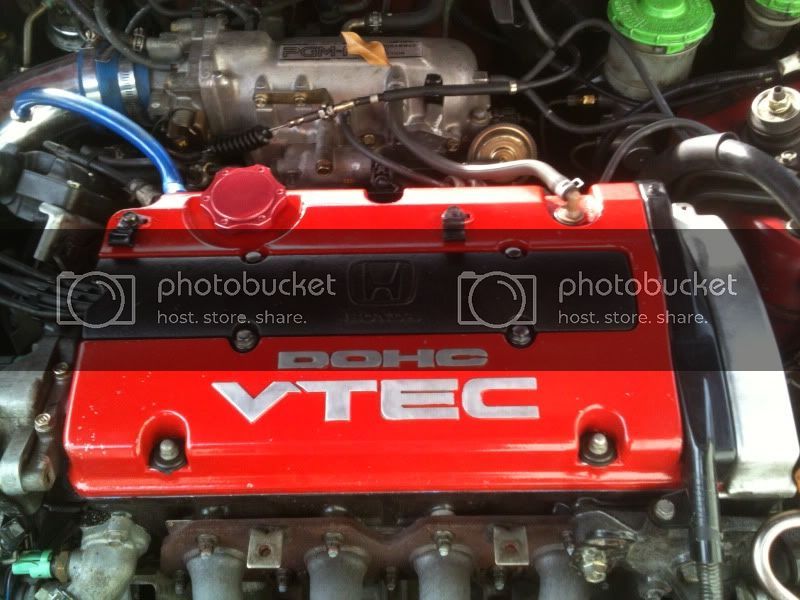

Pics of the motor

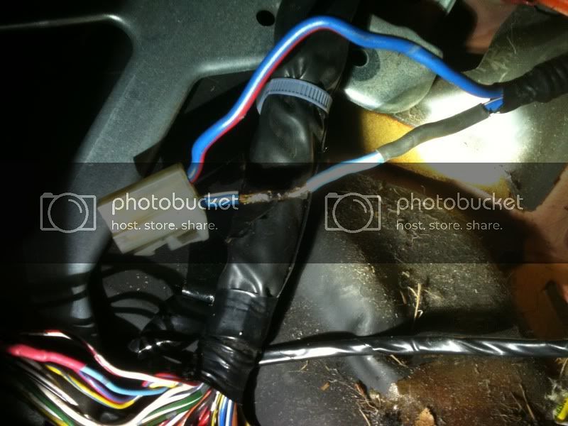

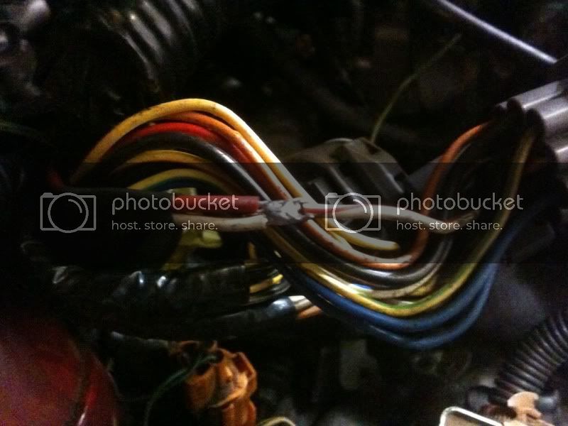

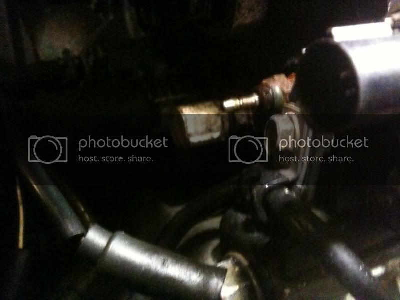

Its the sensor with the white plug that I wired in.

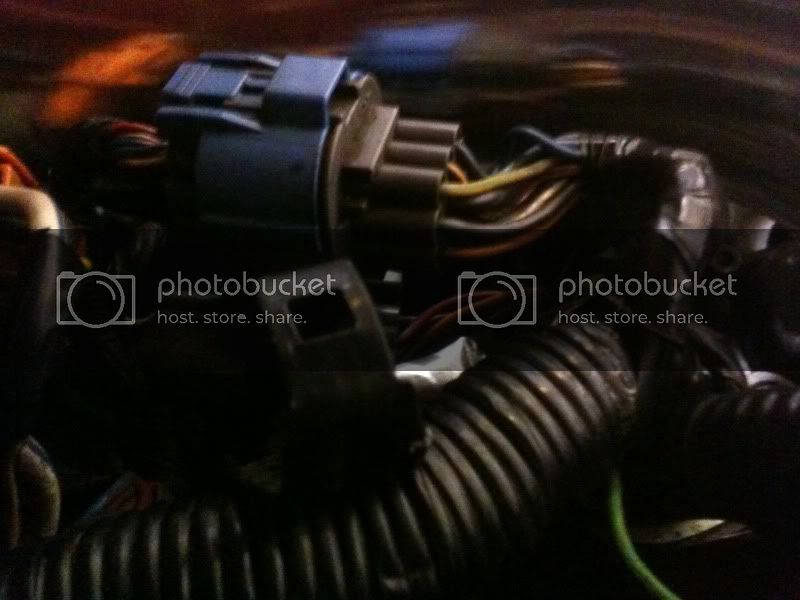

I ran the wires through the main harness to make everything look like stock. You can see the red wires going in and coming out of the harness, and the 2 plugs on the end. One is the one I wired in, the other was just crimped on and jimmy rigged together.
D13 is where the ECT sensor needed to be wired in...it is a white wire with a red stripe located on this plug. This is after I took the black tape off from around the bumdle.
I cut the wire, stripped, tinned, and connected my ran wire in with it.
After heat shrink and replace the black tape, it looks just like stock.

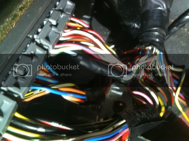

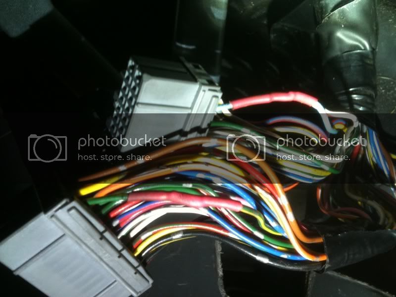

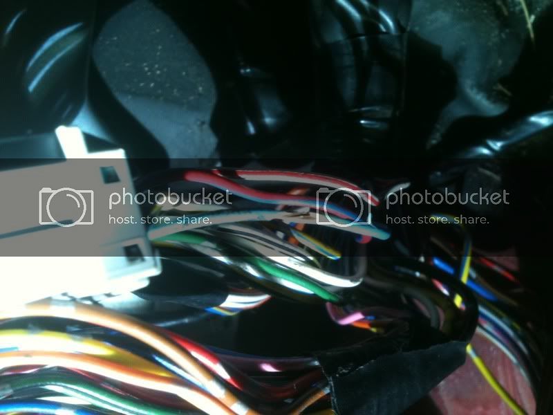

Then I moved under the dash to fix the wires to the ecu.
There was black tape wrapped around a couple of the wires, and when I took the black tape off, the wires were exposed underneath.
A bit of solder and heat shrink and its back to new!

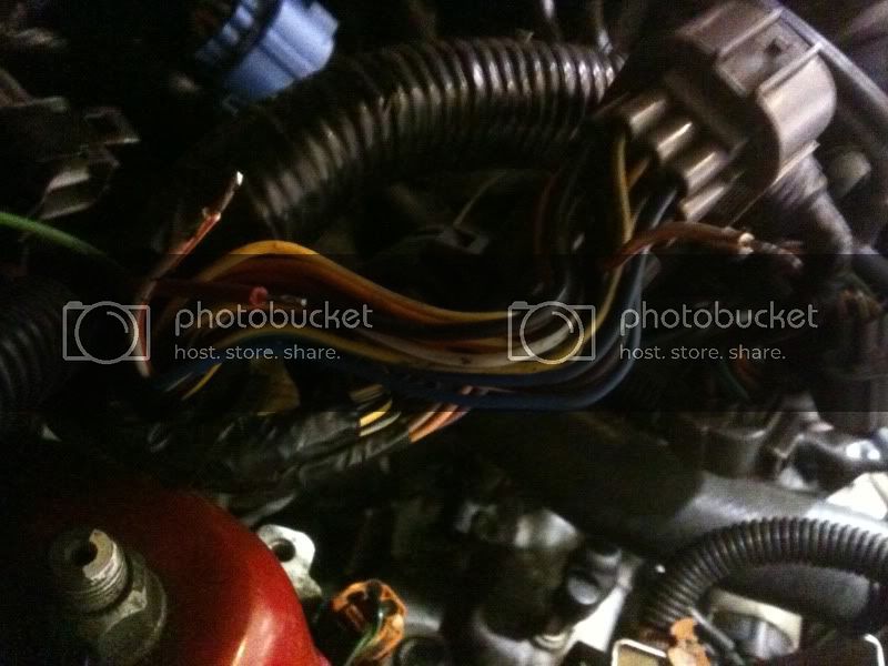

Then I moved to the blower motor. You can see the cut wire, and how he ran it over to the left. That wire was wired directly into the heater switch.
Solder it back together and everything is good as gold.

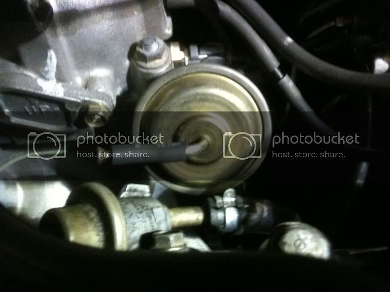

Next is to order an air boost valve block off plate cuz this just isnt cutting it for me.

I talked to my father in law who is a mechanic, and he said it seems like a temp sensor isnt working and its telling the ecu that its alot warmer than it actually is when its cold and not giving it enough gas.

Good job on the wiring.. You can make your own plate if you have the materials..
I would, but I dont have the materials on hand, and it would be just as much to buy one as it would be to make one I think. I found a place online that I can buy a block off plate for $18+shipping.
Although, I have been thinking about it, and I might try to hook the air boost valve back up since I am having problems with it starting when its cold.

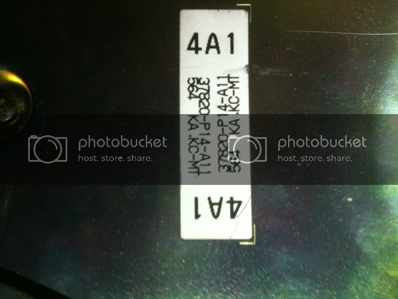

I feel all mixed up when it comes to whats going on with your car
What happened with the FITV stuff?
How is your car's running temperament changed since the VTEC ECU was put in??
Do you know if the original ECU (when you bought it) was chipped?
What about the CEL bulb/wiring? Need to take the cluster out unless you can see from under the dash.
