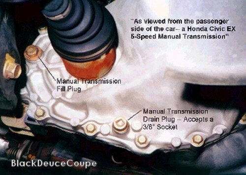

Should i do this my self or take it some where.
is it an easy thing to do,i have never attempted? and i hear it can be bad to change the trans fluid because it can shock your system, my car has 111000 miles and i believe that should be fine and wont hurt it.
a gm dealership, or Penzoil makes a copy of it which you can get at most autoparts stores. Thats what I have always used.
changing the fluid is pretty easy. take the speed sensor out, then remove the tranny drain plug to drain the fluid. then the normal fill plug so you know when its full. get a long skinny funnel and pour the fluid through the speed sensor hole till you see it start to come out of the regular fill hole. onoce that happens put the fill plug and VSS back in and enjoy. half hour tops
