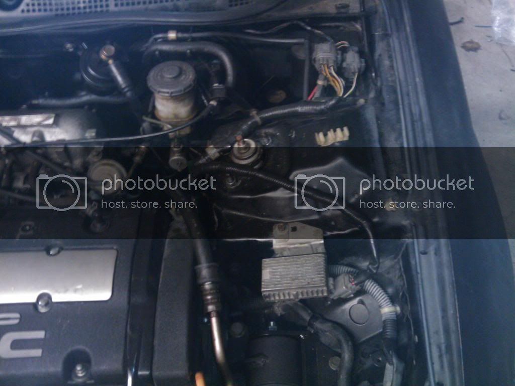

    yes, strip the plastic wire loom on your harness on where the small peice goes to the injectors close to where it goes to the main harness. there are four yellows/black and a red,yellow,brown,blue, and i cant remember what color the two for the iacv are, but, cut the four yellow/blacks that go to the injectors close to the main harness and connect the 4 red wires from the resistor box to them on the injector side of what you cut. the four others that go to the main harness go to the single yellow/black that comes from the resistor box. make sure you add enough wire to mount the resistor box on the shock tower . throw some loom on it and your done.
  19. daloco1
    daloco1 New Member
    70
    Jul 31, 2009
    williamsburg, va
    i put mine here because i eliminated power steering. [​IMG]
    1 person likes this.
