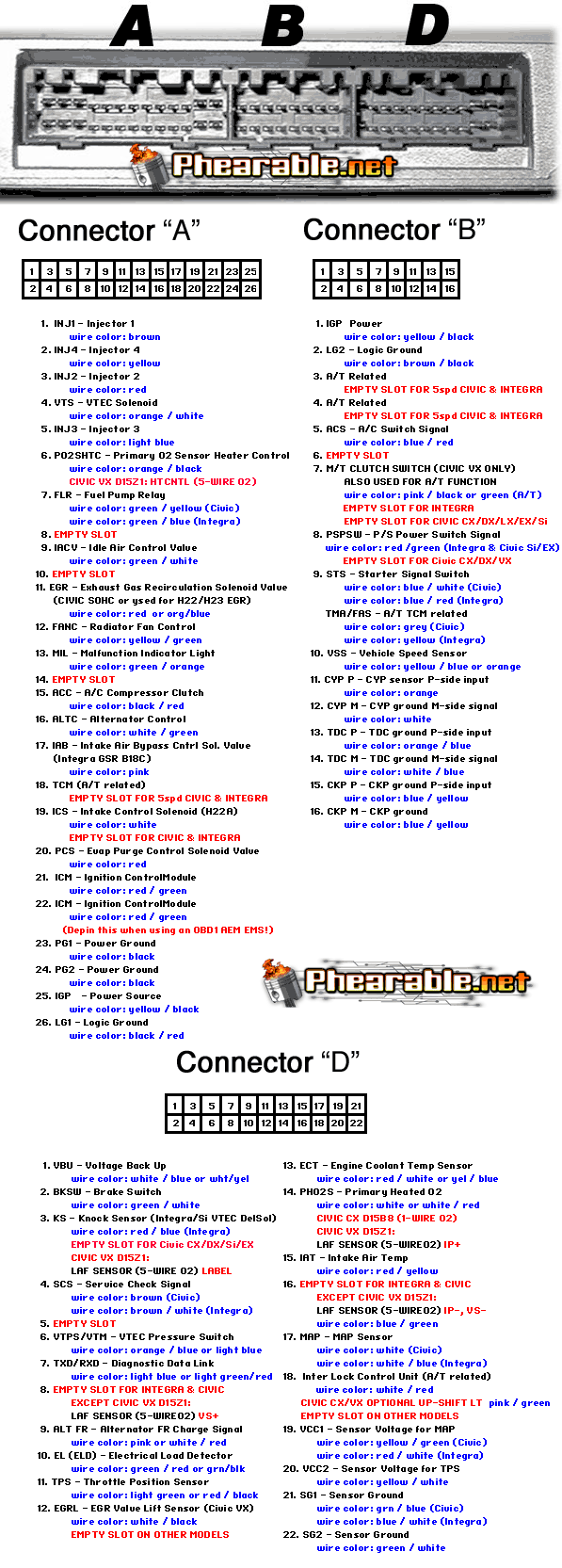

    Tech - Injector Wiring
    this will help too..
    http://www.phearable.net/tech/wiring/obd1.pin.schematics.gif
