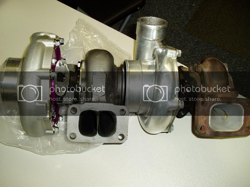

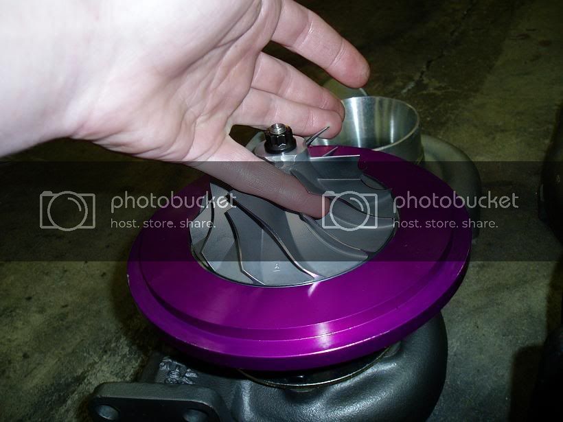

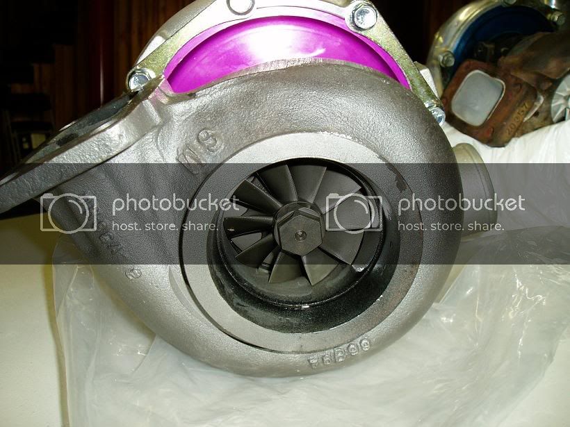

Using aem ems, a dual ceramic bb gt72/divided tang t3(with a t4 wheel) basically the biggest t3/t4 possible, dual tial 38mm wgs, custom built top mount manifold etc etc...

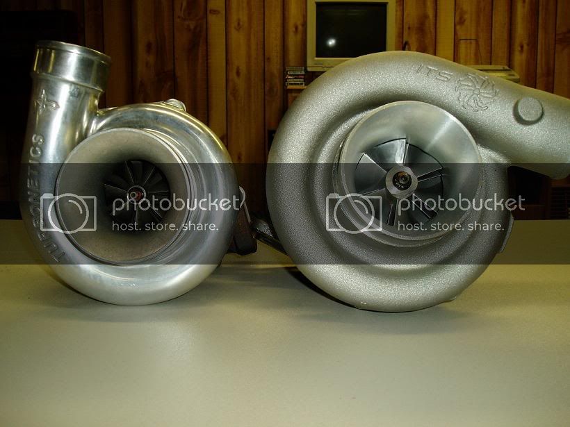

the smaller turbo in the pics is my old 60-1(to4s cover 4in inlet) enjoy..........

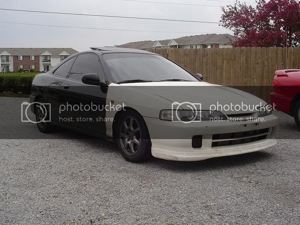

front end is at the booth right now getting color matched. With the new setup i went to a back doorstyle IC with eliminated 36"of IC piping! Full boost is expected in the 4750ish range, no later than 5k

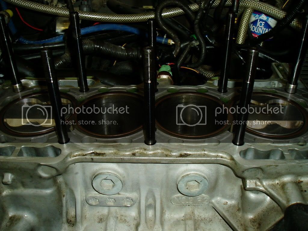

not sure what else you wanna know, i can't give it all up ha.uumm, well the head is being built by bryan laforrest of bully performance, expected to be very well off in the 300s. Stock IM is also being heavily modified. 1600cc injectors, sumped stock tank and possibly spray haven't decided yet. I need money for axles (dss stg5=1300 bucks ouch)
