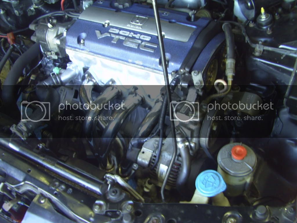

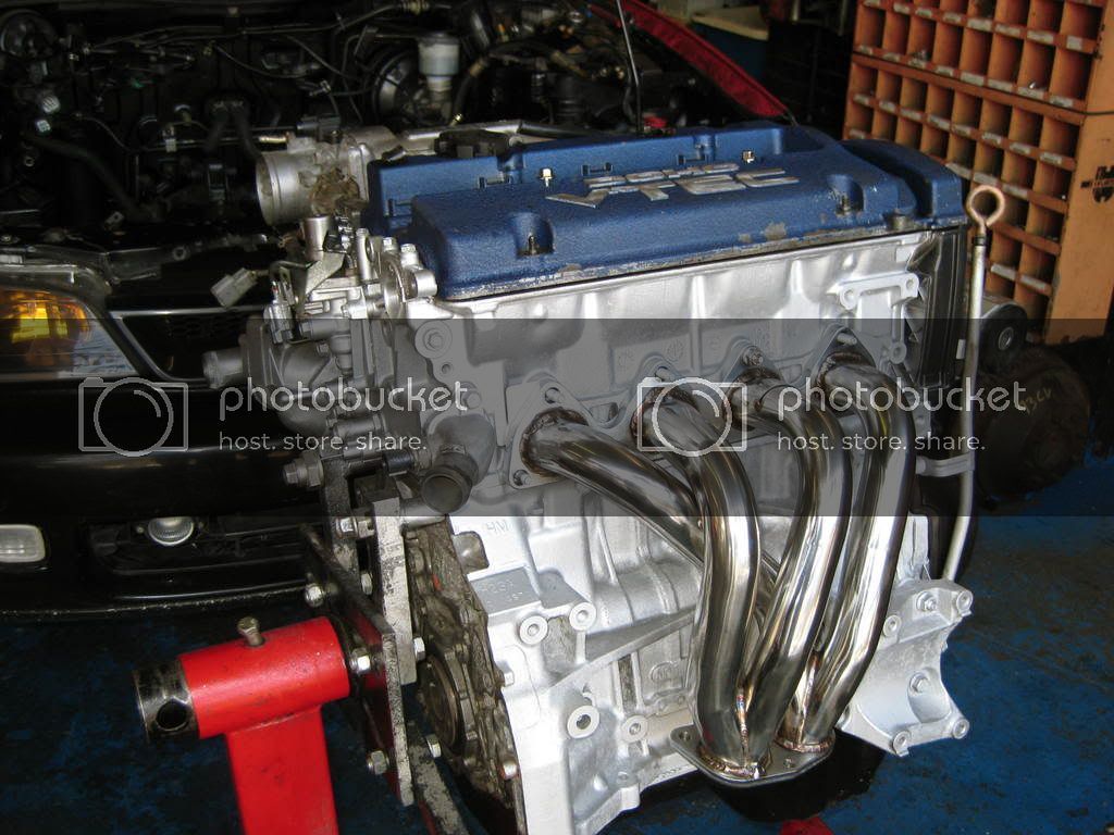

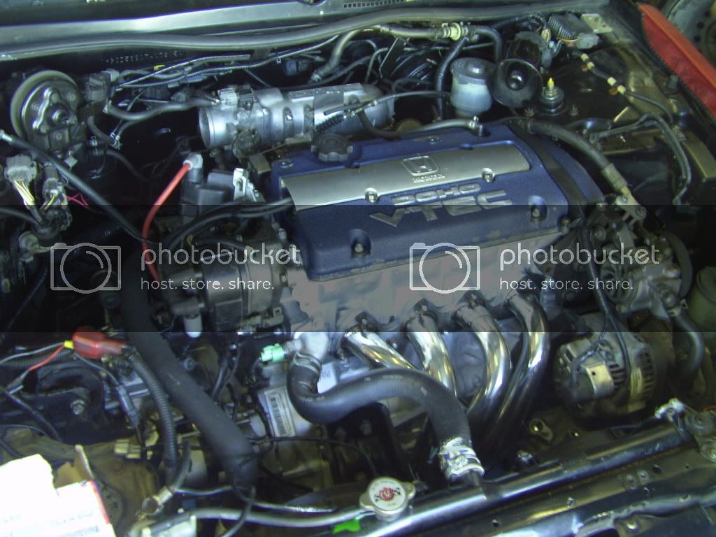

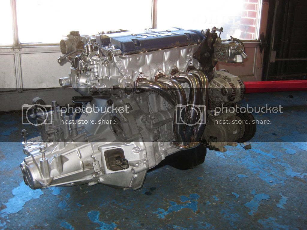

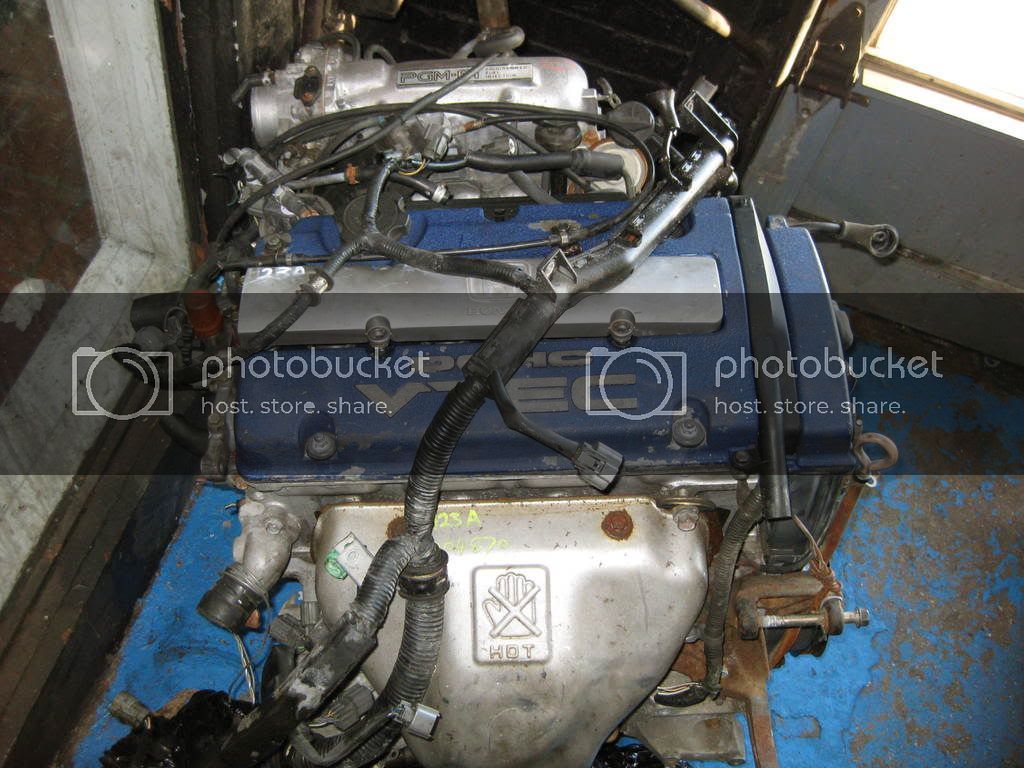

i know this thread is old but i just want to show you guys my H23a Vtec from the Accord Sport Wagon sir...i have not dyno'd it yet since i am still working on it..but it was not a bad swap. here are some pics of the swap. ohh this went into my 5th gen accord full conversion from auto to stick and swap from f22b2 to H23a vtec
