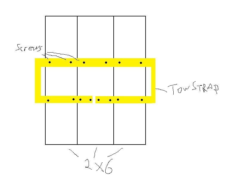

  13. E_SolSi
    32,221
    6,001
    get some cheap tow strap
    place the 2x6s side by side
    loop 2 runs of tow strap across the 2x6s, making loops for handles at both ends
    cut to length
    melt the ends so the webbing doesn't unravel
    secure the tow strap to the 2x6s with washered screws (probably worth melting holes in the strap to put the screws through)
    portable
    foldable
    has handles
    BrutalB83 and reckedracing like this.

  17. BrutalB83
    11,756
    360
    Jun 24, 2006
    Rochester Hills, MI
    Yes! this is the kind of stuff I was wanting. My ideas were either that or some kind of metal strap:
    Actually, maybe one on each end, both set back a bit to avoid the ground on the bottom and the lip of the first slab on top? OR, maybe even put them on the ends of the 2 x 6's (assuming I can find a board thin enough or cut something to size)?
    Hadn't considered tow straps at all, but that might work. I'll have to look in to it.
    Yes! This is the kind of shit I was hoping for.
