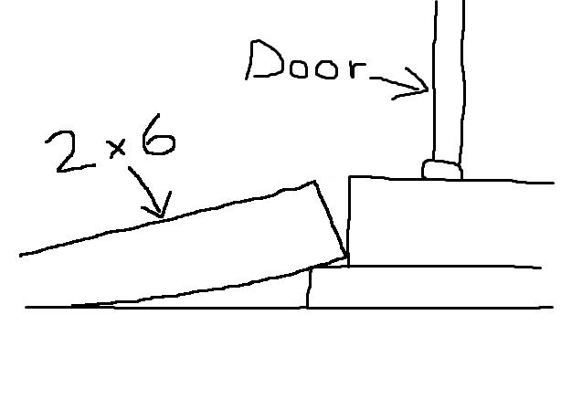

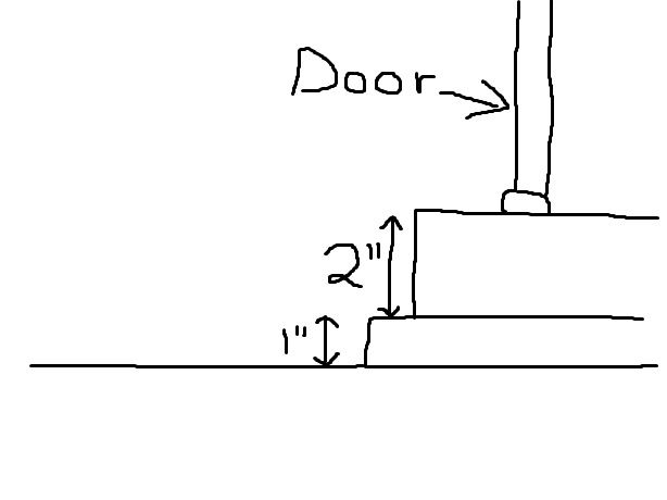

I keep my RSX in a storage unit for the winter. The unit is built on a big slab, and then each stall has it's own slightly recessed slab, so it's kind of a "step up" to get in to it.
See shitty MS Paint illustration # 1 for a visual:
I can get the car in without any sort of ramp if I give it a decent amount of gas, but it's a little more abrupt then I like, so I just chopped up an 8' 2x6 in to four 2' parts, and I lay the boards down next to each other (2 per wheel) to use as ramps.
See shitty MS Paint illustration # 2 for a visual:
This works well enough most times, but sometimes the boards will move around a bit if I don't hit them just right. Also, it's annoying to have to lay them out and pick them up individually every time and I also have to line them up with the wheels pretty precisely seeing as two 2 x 6 boards next to each other are just barely wider than the RSX's tires.

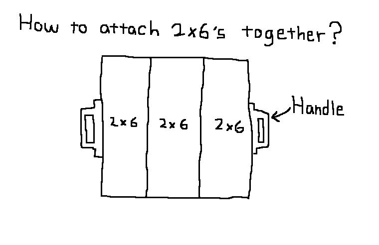

SO, I'd like to build something a bit more permanent and quicker/easier. I'm thinking get a 12 foot 2 x 6 and once again chop it in to 2' sections. This will give me three 2 x 6 boards for each side, so I can have a wider surface and can then be less precise with my placement. I also want to attach the three boards together and then screw some handles on to the sides to form two ramps that are quick and easy to lay down and pick up.
See shitty MS Paint illustration # 3 (attachment # 3) for the proposed ramp:
So my question is, what's the best and most secure way to fasten the three side by side boards together?

Take the boards you already have. Add wood glue between each face of the boards then screw them together till the glue sets. As long as the boards aren't kept in the elements they will be fine.
Kreg pocket screws would work but dont know if they will handle the weight, but it might work.
Is there enough room to bolt on a piece of wood underneath?
Huh? I'm not attaching them face to face. That would make the ramps super thin. They're laid side by side. I suppose I could still add some wood glue to the mix, but how would I screw them together? Go from the top of one board into another at an angle?
Yeah, I think there is. I'm probably going to go that route, or try E's tow strap idea.

@BrutalB83 If it were me I'd stop at your local Ace/Home Depot/Lowes and go to the metals section. They have short lengths of steel with holes pre-drilled in them. I'd use a couple of those and run some screws into the boards to hold them together. For a handle, I'd stop by the cabinetry section and grab a cabinet door handle for each side.
the metal strips idea is nice, but the cabinet door handles would need to be drilled from the back and you would need to buy extra long screws to go through the thicker board
i would look for some type of handle that you can just screw from the face
Sorry I misinterpreted your sketch. You could still glue the edges and screw at an angle with some pre drilling. You could also get some pre drilled metal stock and screw them across the underside with some 1 inch screws as brackets. Think like the back side of a fence gate. The metal stock you can get at any home improvement store.
