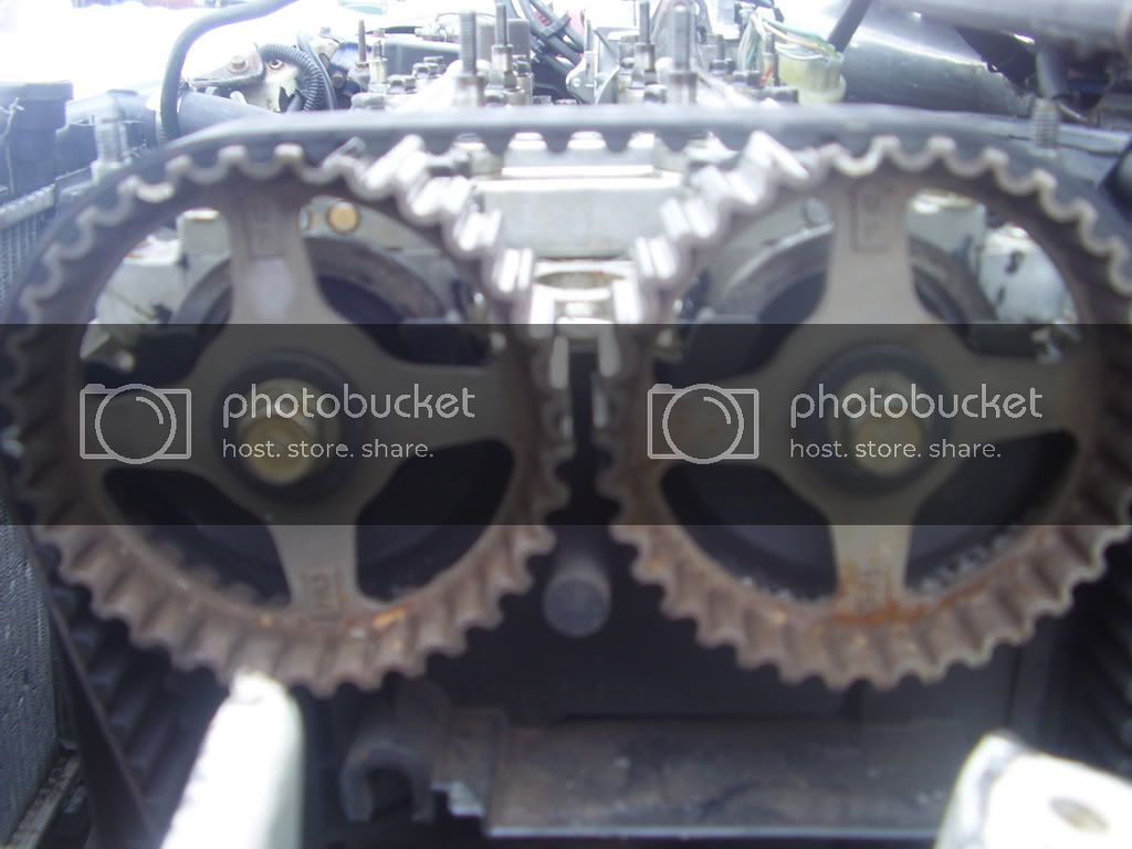

here's pics the cams dont look lined up to me, the little index marks sre off but only a little bit, LMK if you agree so I can bring it back and have it done over.

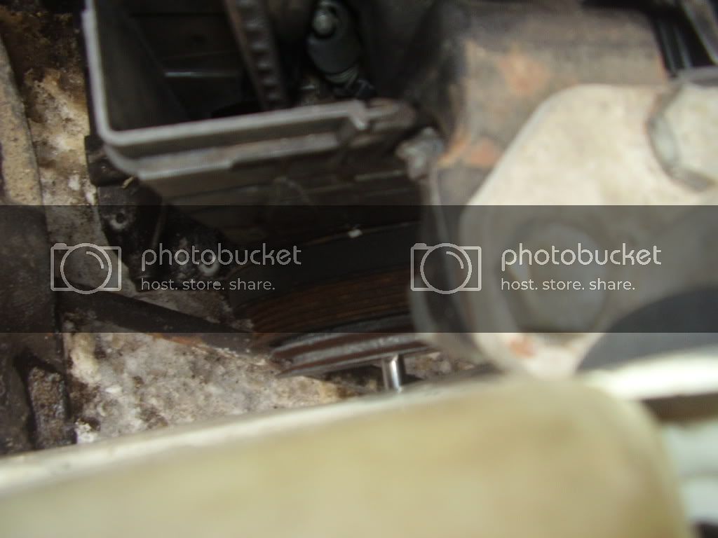

I have the crank at TDC in this photo.
I can't really tell from the pic if the crank pulley is at TDC. If it is, I think you're timing is fine, because the cam gears look about right. The arrows should point slightly left from strait up relative to the head, while there are little embossed lines on the edge of each cam gear that should be pointing directly at eachother.
if the notches point directly at each other they are off by 1.5MM, it didn't look like a whole tooth to me but off a little.
my haynes manual tells me that the arrows should point slightly off center to the left, and that the notches should be alligned
As long as the cam notches line up with each other when the crank is at TDC then it's installed correctly. It looks right to me in the pics.
