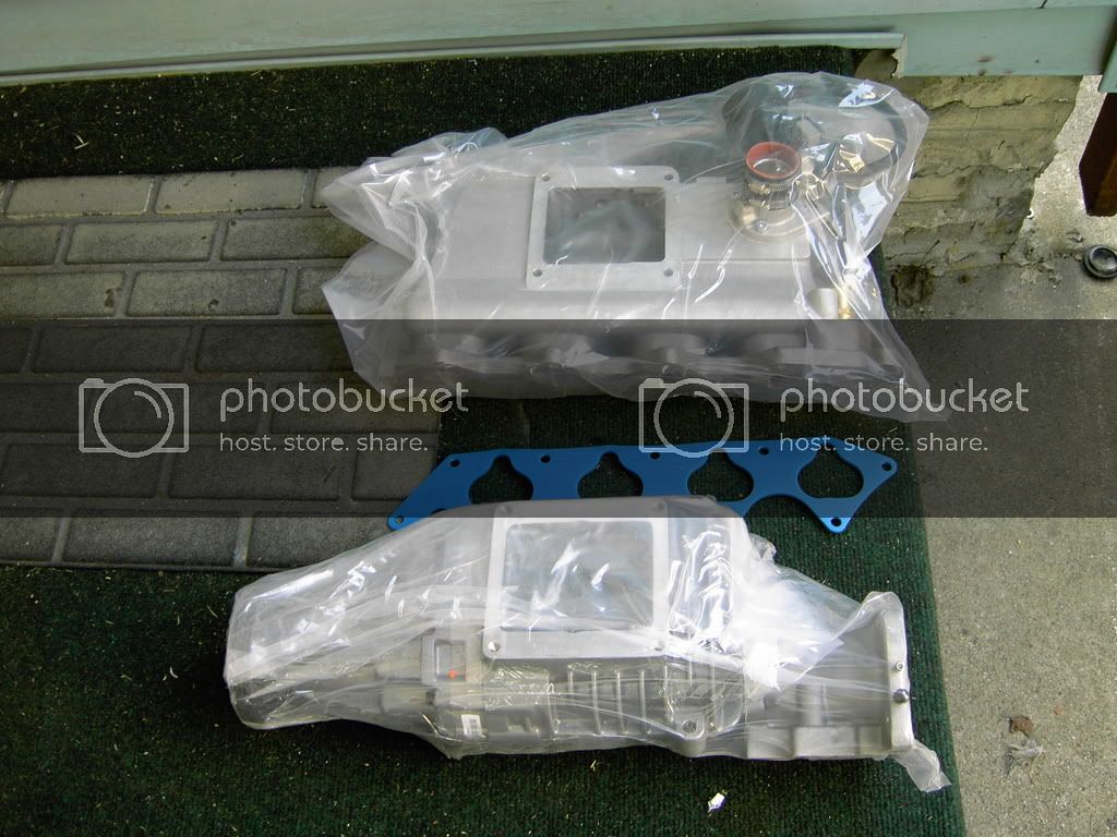

    Ok this is my long awaited build:
    List of shit done:
    93' DX Hatch
    JDM b18c (gsr) from hmotors
    ARP studs, new HG
    JRSC "high boost" kit, 8 psi
    Hondata s300 on RC 440's
    Hondata intake gasket
    IE
    8 lb FW
    Exedy stage 1 clutch
    eibach pro kit springs on eibach struts
    gsr front and reas disks, with master cylinder, booster, prop valve
    Energy Suspension bushings all around
    si wheels wrapped in Kumho AST's

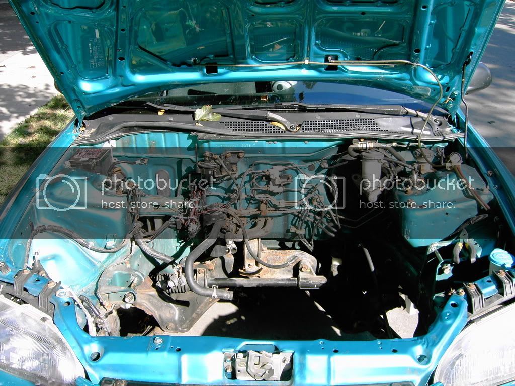

    Here's the car as it sat during the swap:
    [[​IMG]

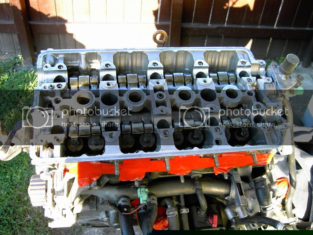

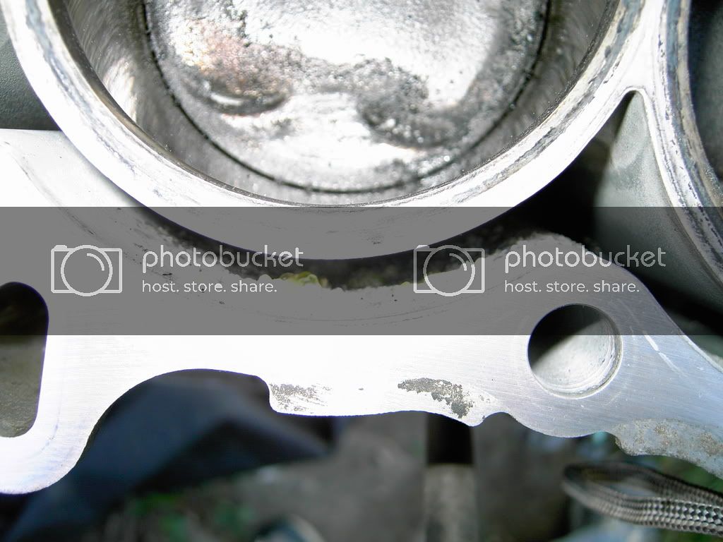

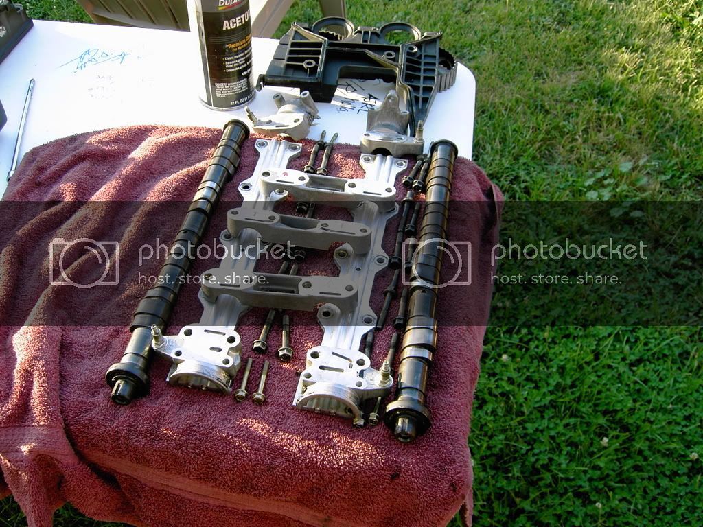

    Head looked good
    Block looked good too
    What's this green shit growing on the sides of my water jackets?

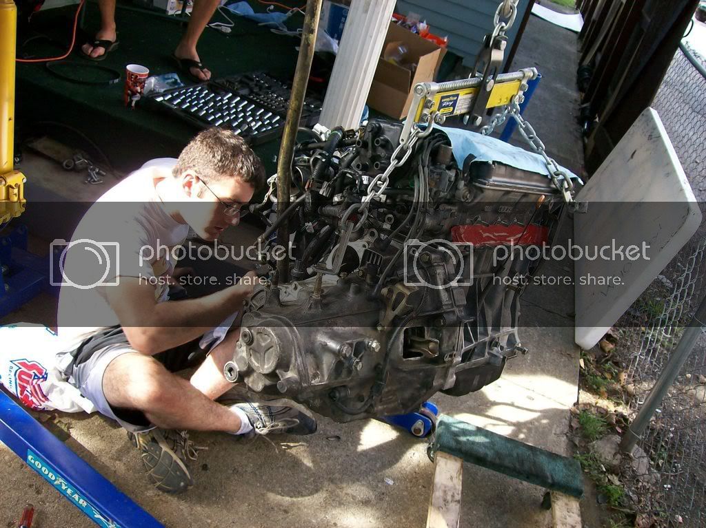

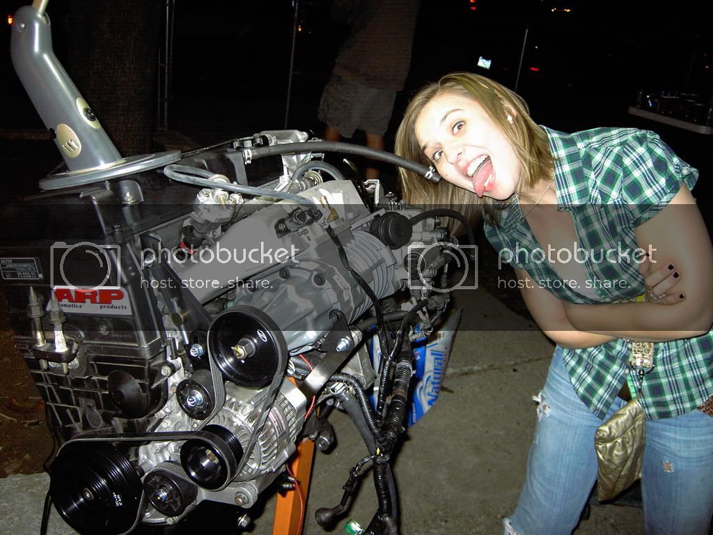

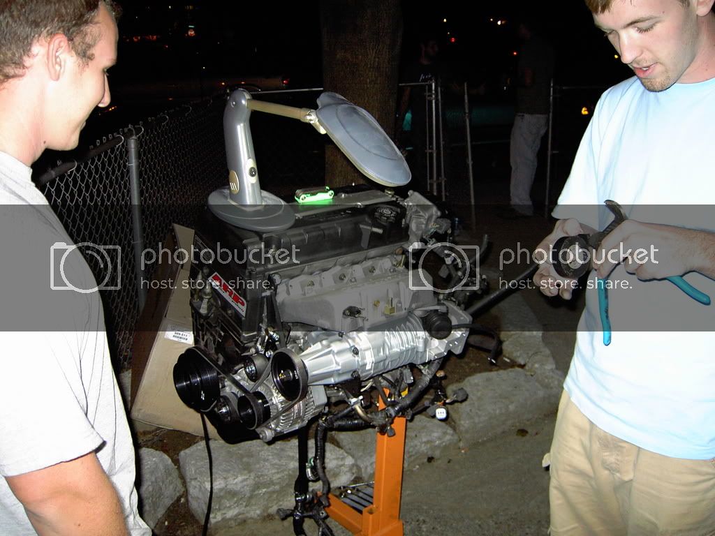

    Bolting the SC up to the motor:
    We worked into the night...

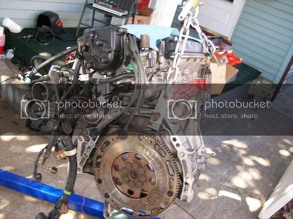

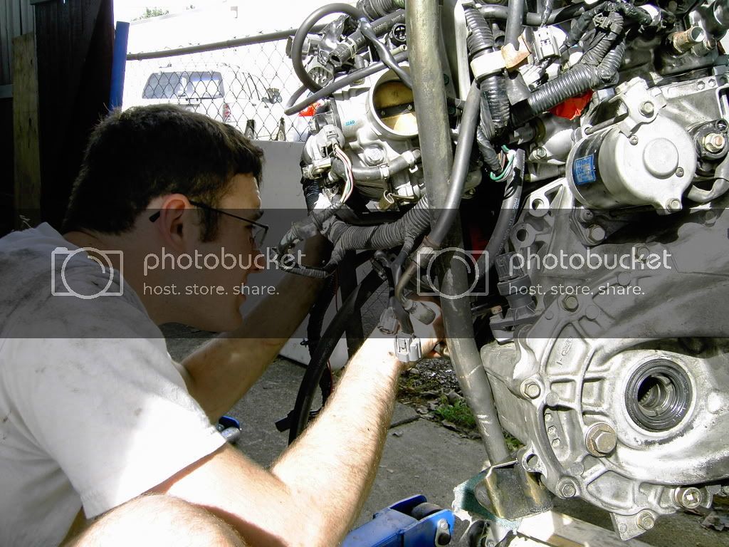

    The next day I bolted the trans and other random stuff up to the motor.

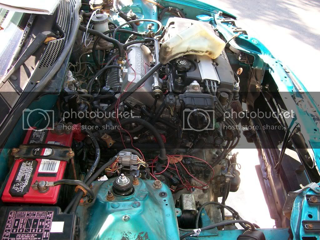

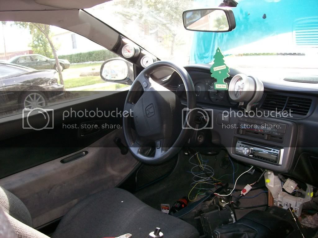

    My buddy worked all day getting all the electronics and guages set up.

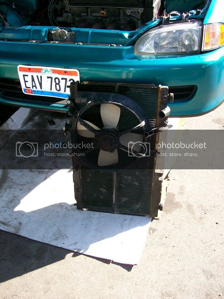

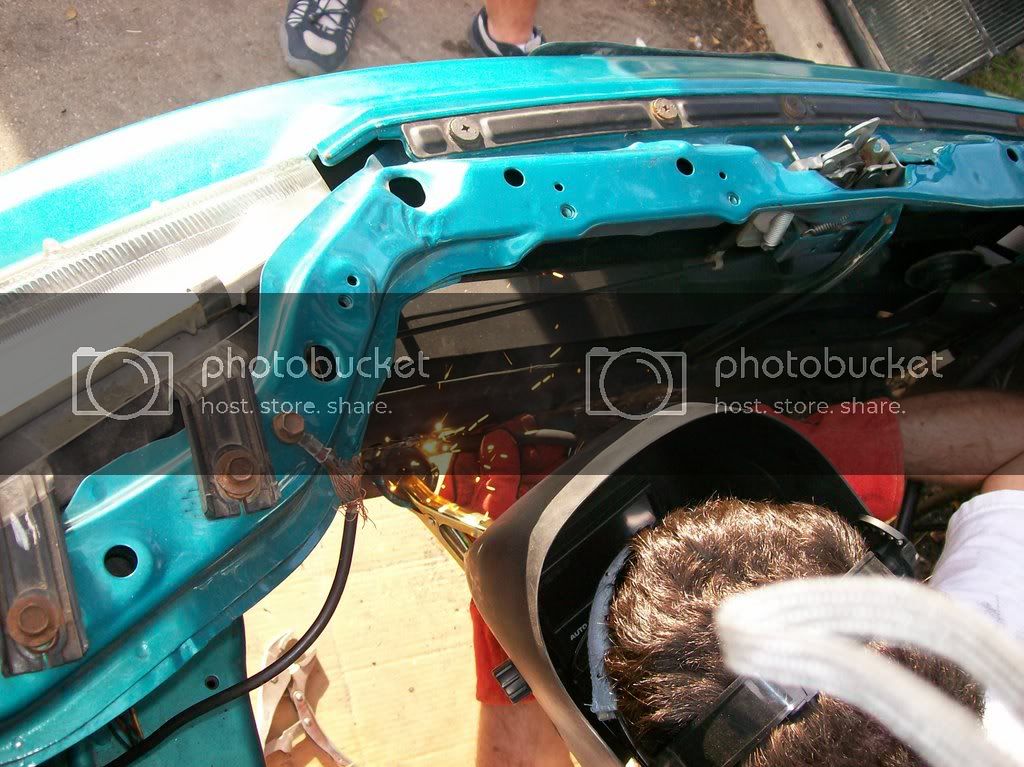

    The car now has an integra radiator, so we I had to do some cutting and welding to get it to bolt in.

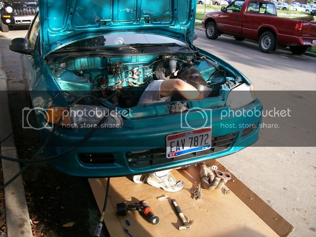

    It took three tries to get the motor in right. Its a little tighter than normal because the supercharger pulley sticks out pretty far.
    Almost done!
    Well, thats all that I have so far. The car is done now, and runs and drives. I just havn't gotten around to taking pics of the finished car because I've been working alot on the tuning. Driving the car, it is a hell of alot faster than w/o the blower. Going from a stock d15 to this beast is rediculous. The car has an amazing powerband now. Power is plentiful all over the rev range. I was able to pull away from an s13 that runs high 12's when we were just messing around. Now I need to get it tuned, and get a header.

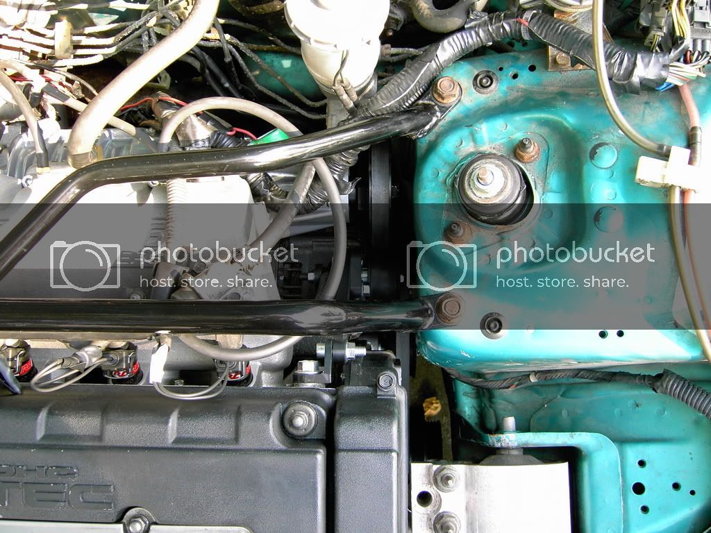

    I'm thinking of doing the exact same thing to my B18c1 eg hatch. I was wondering how the whole alternator/pulley system fits in there, because on my car theres less than 1 inch between the alt pulley and the body of the car.

    Swapping in the street FTL:D I'd much rather have a garage. We worked into the night, and finding tools and misc bolts in the dark made me want to kill somebody. Either way, it was alot of fun.

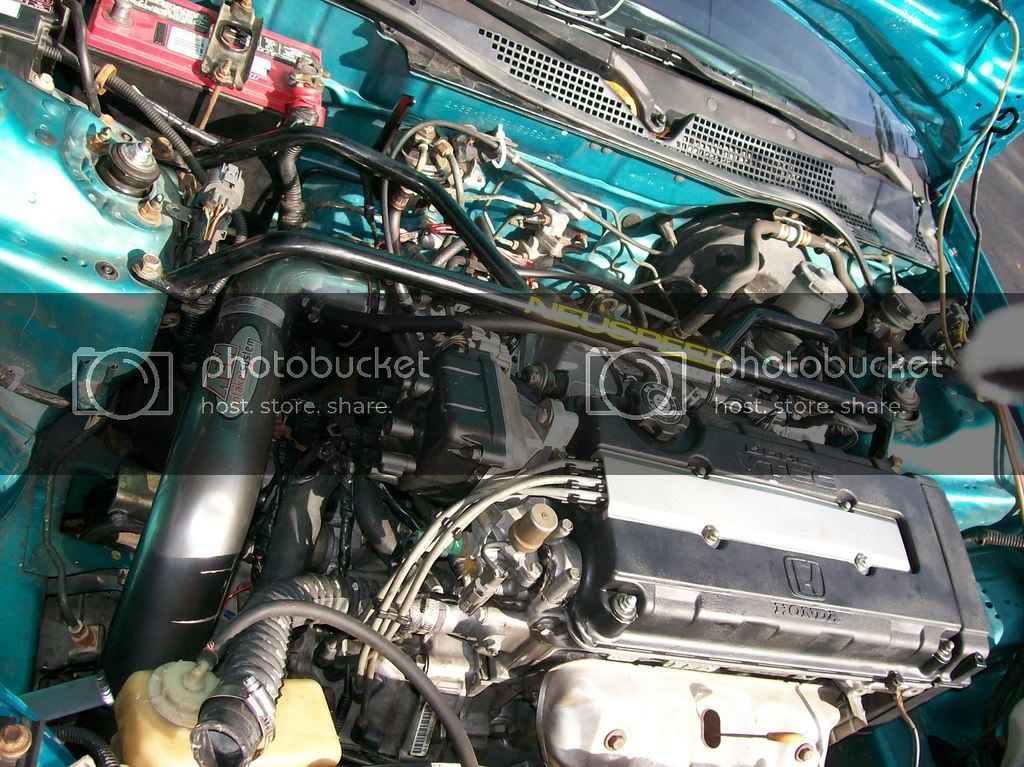

    Some completed engine bay shots:
    You can get an idea of how tight the pullies are to hitting the chassis...
    There was like a half inch clearance between the alternator pulley and the chasis. I can't even fit my finger in the gap. Its tough to see in the pics because its down in the engine bay. So yes, it does fit. Its just a tight squeeze.
    I installed everything prior to putting the motor in the car. This made it alot easier. I can't imagine what a huge bitch it would be slapping a jrsc on a gsr motor thats in a car. It can be done though.
    The girl in the picture kept bugging me to come out and drink... I really wanted to, but I wanted to get the car done, and couldn't ditch the guys who came to help. The goal was to get it done in a weekend. The d15 got pulled on a thurs night, everythign showed up via UPS friday, and the car was together sunday.
