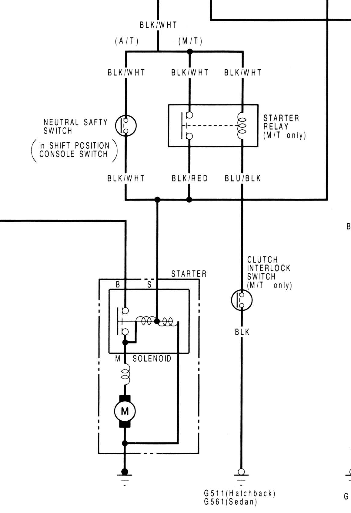

    hey so im working on a 91 civic hatch si... just put a poor mans type r in it and tucked harness.. im having issues with starter... the relay mounts on the side wall by underdash fuse box has two blk/wht wires, a red/blk and a blu/blk wire. the wht/blk wires come from ignition to fuse box then to this relay in the start position... at that time i get power to the red/blk but not to blu/blk.... this blu/blk wire runs to the clutch switch then to ground according to the wiring diagrams i have.. where is this ground junction? and how can i test the relay? any help is greatly appreciated View attachment 23160
