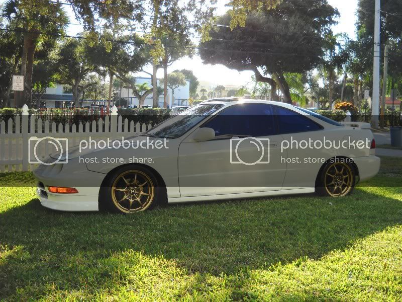

I know most of the regulars have seen it, but heres a couple pictures of my car so you can see the stance i keep it at.
this on 16x7 205/45 tires
