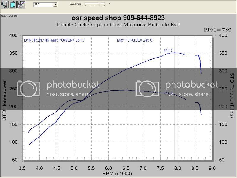

i would recomend a t3/t4 with a .63 ar and a 57 trim have one on a B20 vtec and here is th dyno at 11 psi on 91 octane no lag boost around 3-3.5 full boost right after vtec around 6.first-3rd gears are spinning as soon as you get in it.its in a hx ek coupe ran 11.8 at 124 mph at california speed way and its a daily driver
