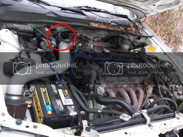

Help!!
I think it would be located in this general area...
in Civics yes... but that is the charcoal canister .. try looking underneath that

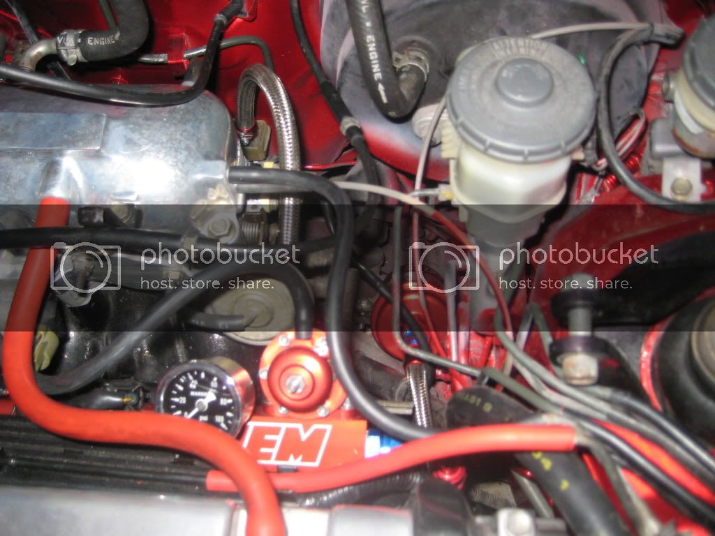

actually i'm thinking its under the brake fluid reservoir on Preludes and a pain to get to
yep.. see the red thing way under the brake fluid reservoir .. thats the fuel filter(aftermarket though).. so thats where you'll find it..
now i can see why you havent found it.. lol.. shits hidden
damn that is in there huh..probably easiest to get to from underneath...and for all the help and suggestions do we get reward?
A reward for a good deed. This is why my dad told me (at 15) to never run out of gas b/c it brings on problems from all over the place
From someone that has had to change one of those.. there is no easy way to get at them.
