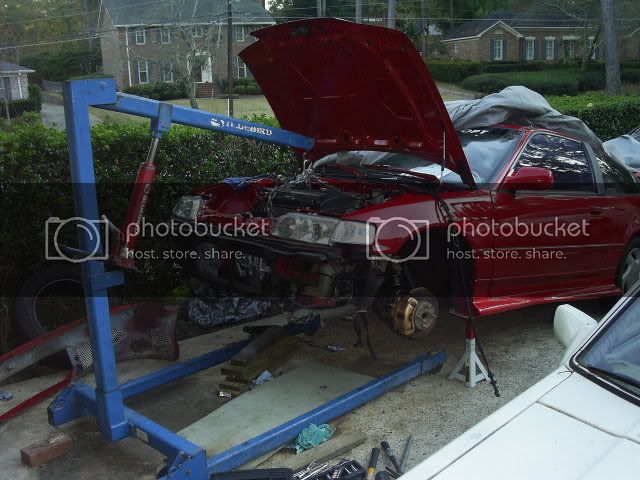

You dont need a shop. I did all of my swaps in the driveway. You can rent an engine lift for $50 bucks. The lift I rented comes apart. It's only 6 Pieces. A 2nd grader can put it together and take it apart. You dont need a lift to drop the old engine out of the car. You jack the front of the car up high enough so you can pull the engine from up under the car. When you are about to drop the engine you can put an old tire (that's not on a rim) or a trash bag stuffed with straw or leaves up under the engine to provide coushion so you dont damage it.
