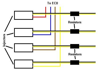

    Injectors: Quoted from G2IC Turbo Guide - A Guide to Turbocharging your Honda / Acura Integra Great writeup here, could skim over it to see if you missed something. I'm no turbo pro.
    Just tossing shit out there.
