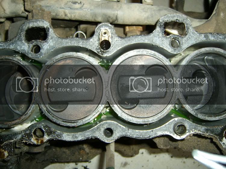

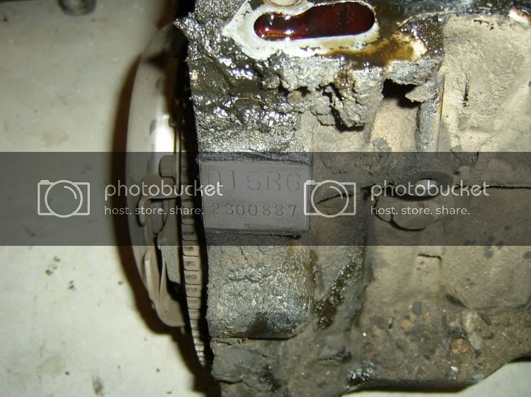

ok, i got bored so i got out to the garage and pulled the head off. heres what i found....2 valve reliefs per piston, btw this is out of an '89 HF

so ok the head swap wont work so pr3 pistons are in order now? wil lthose go straight in? the bore and connecting rod width and all that
Sorry- that should be PM3, not PR3. PM3 is the D15B2 piston- PR6 is for a B16. The PM3s should drop right in and slide onto your stock rods.
