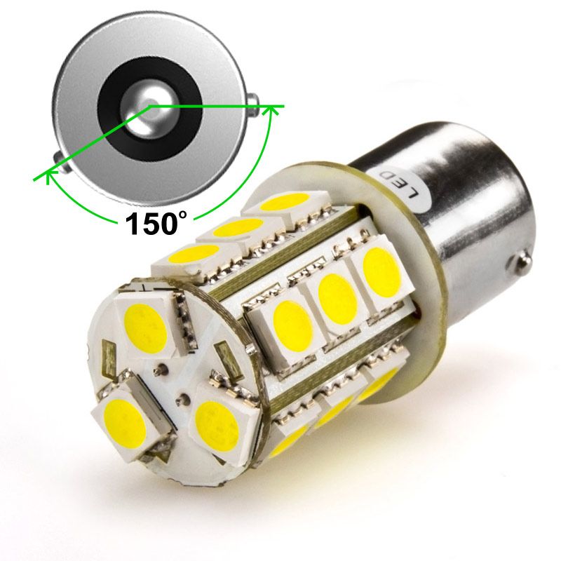

Why not LED? Get the good ones:
BAU15S LED Brake Light, Turn Light and Tail Light Bulbs | LED Car Bulbs | Super Bright LEDs
If there were an error free led he might... but without putting a resistor or new flash relay it would cause hyper blinking
New flasher is like $20... and some of the newer higher end LED replacements come with resistor packs in them already.
