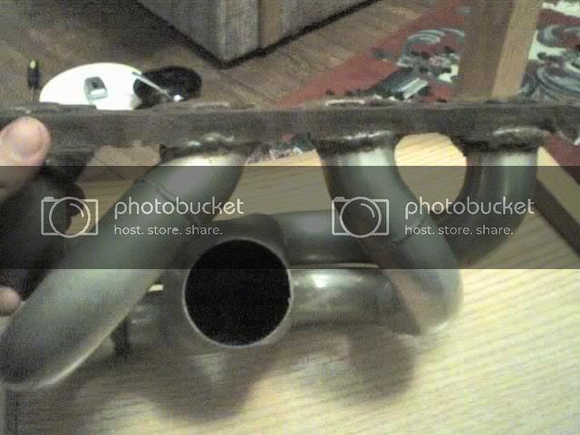

so i am looking to put a t3 in place of the 14b in my car in hopes of actually passing the 200whp mark on the dyno. here are pics of the manifold i made to pass this goal.

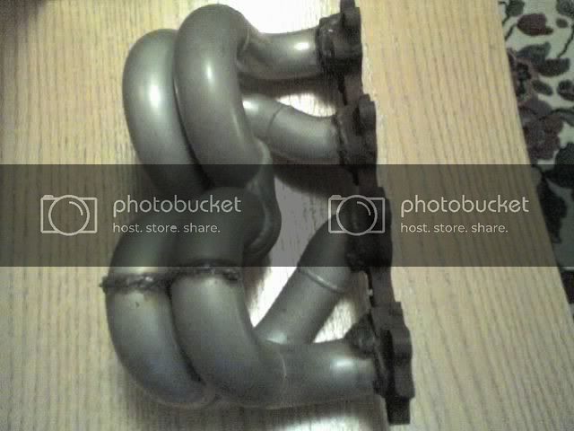

I managed to buy an old manifold that my friend bought for his focus for the price of a full tank of gas then i cut it and welded it to a fitting b-series exhaust manifold flange. all i need to do is mock it up for turbo fitting.
you can see where i had to cut the manifold in order to bring the runners closer together. I am hoping that this manifold will flow many times better than the DSM manifold i cut apart before. it should fit better since i am using a honda flange ratehr than one i made myself, so less worries that it will spit out a gasket.
your sig says it perfectly, how do you like my welds, they could be better, all i made sure was that there were no holes, the material was fairly thin.

yeah the welds look like shit...lol
But as long as there are no leaks you should be fine....

what did you usea mig with what wire? you cannot weld cast with a mig. Its gonning to crack at the fla(n)ge
I don't think there will be too much to worry about with cracking, this material is thinner than the heavy cast manifold i currently am using, but it places around the flange and when i weld the T3 flange on i take extra care to make the welds solid and the flow is uninterupted, by taking my time with a grinder and rewelding when necessary smooth changes should prevent hot spots on the manifold and therefore i can hopefully avoid any cracking issues. The piping is ford racing so i trust it be well built.

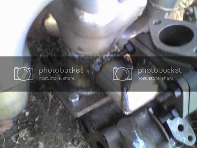

you should weld up some support brackets to it to keep it from possibly cracking under the weght...
Doesnt look too too bad. You're going to need to bring the turbo mounting flange WAY down to fit the turbo.
ideas on support braces? just one per runner?
i still need to weld the t3 flange on i was wait to get everything fit til i could put it on the car
cause i am fabbing the downpipe at the same time.
At least a couple from the head flange to the turbo flange. More is better. You don't want to take any chances on something cracking and dropping your turbo on the ground. With the thinwall materials, the heast cycling of normal operation is going to cause cracking at some point, just keep an eye on it, and weld them back up when they occur.

thanks, (also sarcasm) it waas rough to weld not my best work, that's what i get for never taking classes.

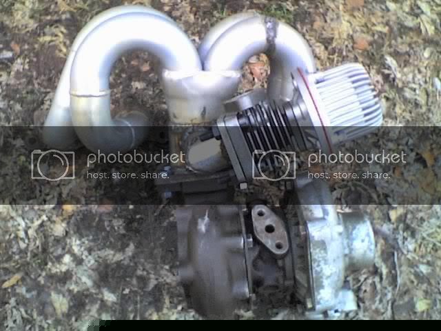

anyway here's a pic of the manifold on my car

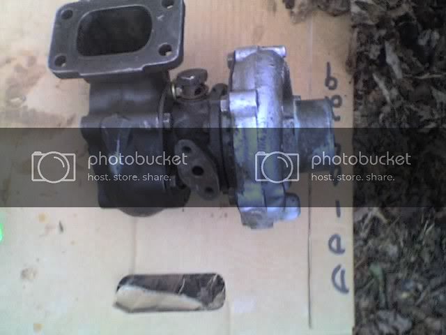

and here's a pic of the turbo that's going in place of my old 14b which i'll miss.
finally the old turbo for size comparo
i decided against bracing, the manifold was originally ford racing so it should be plenty sturdy
finished, i had to angle everything for two reasons
so it would fit
for the sweet jdm look
