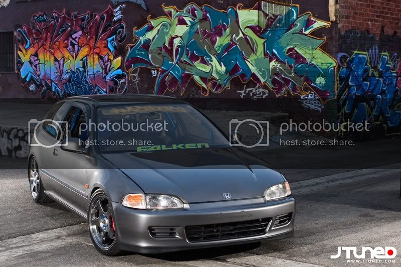

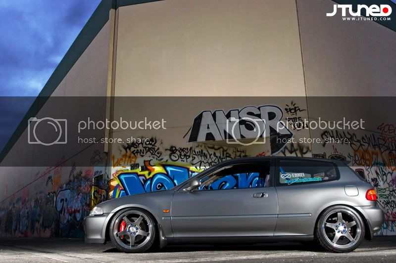

So this is how it should look like when I'm done with it , but without the enkei evo 5 rims .. I will keep the integra type r 17 white rims.. and no roll cage I don't like to hurt my legs when I get out of the car.
