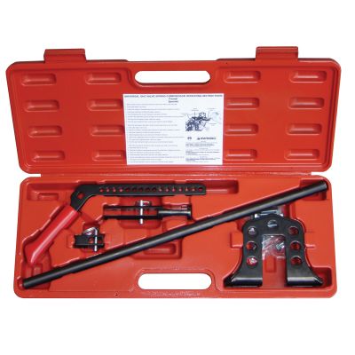

    BTW if you you want to change out the valve springs without removing the head get this. But you will also need the adapter to put a arline into the spark plug hole to hold the valve's up.
    This one is from Matco, i like Matco tools, same quality as Snap On and a lot cheaper.
    MST9140A - UNIV VALVE SPRING COMPRESSOR

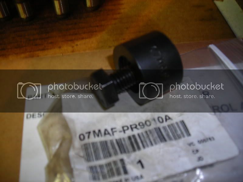

    so i bought the adapter tool from honda for the valve spring compressor and im confused.. they gave me this round metal thing with a large bolt!! wtf is this thing?? i dont see how it could be used for springs.. and the parts guy said they dont even service valves there..they send that kind of work to another shop to be done..
    anyone seen this thing before?

    Call up Jeff at Import Builders...
