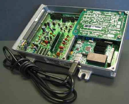

I have standard civic d15b and I want to make some change in the ecu and I thing if I put the hondata s300 with 440cc injectors may be it will give me nice power and increase the hp .
I want some opinions & suggestions please .

Which D15B? JDM D15B no VTEC? JDM D15B with 2 stage or 3 stage VTEC? D15B1/B2/B6/B7/B8?
Tuning will always help on a stock engine, but not all that much. You just tune out the factory "safety margin" and pick up some power. What aftermarket upgrades do you have on the engine to warrant more tuning? If you just have intake/header/exhaust types of bolt on mods without going inside the engine, the stock injectors are more than enough. 440cc is more than most all motor B series guys use on their engines.

if it won't be harmful i will put it but what about the hondata s300 to programming the ECU do you have any ideas about it ?
Did you use it before ?
That still doesn't tell you anything. Is it a T3? T4? T3/T4 hybrid? GT28? T70?
Hondata is good, but only as good as your tuning. The best ECU won't stop you from killing an engine with a bad tune. I had a full Hondata S200 setup on the Civic, and its always served me well.
