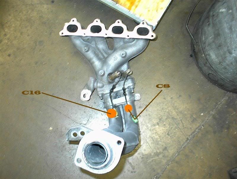

I still don't think you guys are understanding me. Aftermarket 4-2-1 headers have the pipe seperated all the way till they go into 2, which is two pipes till it meets the cat.
As you see in this picture the pipes are pie cutted and welded together, so there is no way to monitor two cylinders at one time unless the 02 sensors are moved lower..
If you look closely you can see it.
I'm talking about moving the 02 sensors down to this area of the piping. It's the same thing just lower.

and if i were you i would just weld another bung into cylinder number 2. believe me, thats the best/cheapest correct way to do it.
im not sure, why not just put them where they should be
Because you can not monitor 2 cylinders at a time with a 4-2-1 header, because the way the piping is made.. I would like to have it as stock as possible, so I don't see why it would be a problem to have two o2 sensors where shown in the picture i posted. (the orange dots)
that should be ok where you have them in the orange. you could still move it up above the flange but it would look like ass there
you can put them down to where its only two pipes,
but it doesnt have to moniter both. as i said before it can just monitor those two and run perfectly fine. as long as its monitoring 1 or 4, and 2 or 3. it will run stock. you said you wanted cheap too. this would be the cheapest way to run it stock and not loose anything.
but its your header and wallet. put the bungs in the lower part. it shouldnt make too much of a difference.

Anyway, back on topic.... the o2 needs 1/4 and 2/3 to be separate. you can't do it in the collector, else the o2 is going to get reading from all 4.
you can't do it in 1 bank, because it will read as half as much as it expects.
if thats the header you have, its not set up right for obd0 applications.
click {POST REPLY} to go to the advanced menu, and then there's attachment options below the post box.
This is incorrect. The o2 sensor only measures the concentration of o2 in the exhaust gases, NOT the volume of gas moving through it. The o2 concentration would be the same weather it was monitoring 1,2 or even 10 cylinders. Invisibledemon is 100% correct. Weld in the bungs on 1 & 2 and it will work perfectly.
dont think so, if what you said is true then he could put it anywhere
No, not anywhere. The exhaust gas temperature cools down as it travels through the exhaust system. It would not work properly if you moved it. It should be placed as closely as possible to the OEM sensor locations.
