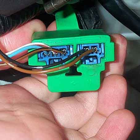

whether your civic was swapped or not.. it should still be there.. have you tried looking up under the dash on the far passenger side..

The thing is...that plug is part of the chasis harness. even with a swapped engine you should still have it.

to be more specific, the green casing is under the dash but the plugs that it contains is not. the swap was real sloppy but the car was the right price. I didn't want to completely rewire the motor (something I am no stranger to) and if I could work out this error code I would just let sleeping dogs lay.
yeah, theyre under there somewhere...if i didnt find it in a few minutes though, id just jump d4 to ground and call it a day.
