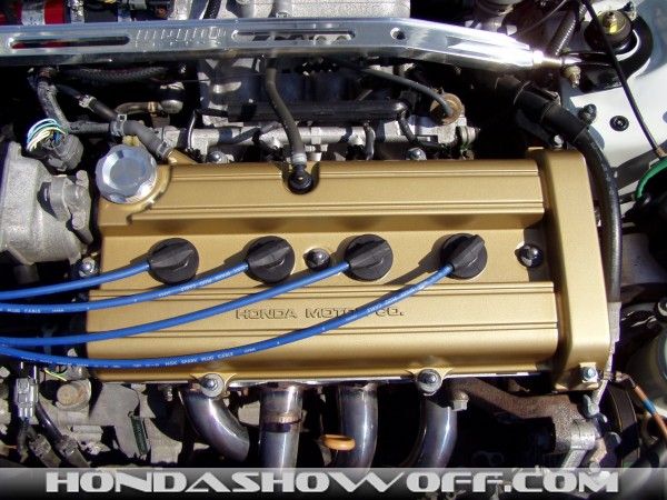

When I did mine I used a sand blaster. If I was in your position I would try to use some paint thinner or paint remover. If not use some 120 grit sand paper. as long as you put a few coats of primer on it and take your time it should come out nice smooth and shiny. Remember when painting to let the coats dry before applying another and not to overspray. Here are some pics of mine.
Before
After

If you have any other questions let me know. Here's a picture of how mine turned out:
here it is how my valve cover turned out!!
