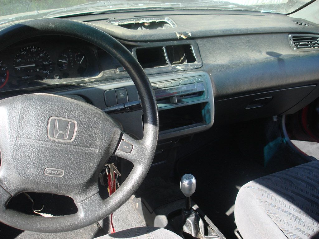

    I wanna combine the two parts, By using the stealthy vent flip down, but insert gauges in it liek the top piece. Im thinkin of doing it on the top vent of my EG dash :
    But im not a super computer wizard. I have moderate level of wiring and soldering etc but not when it comes to "robotics"
    Anyone have any idea so i can start down the right path of reasearch.
