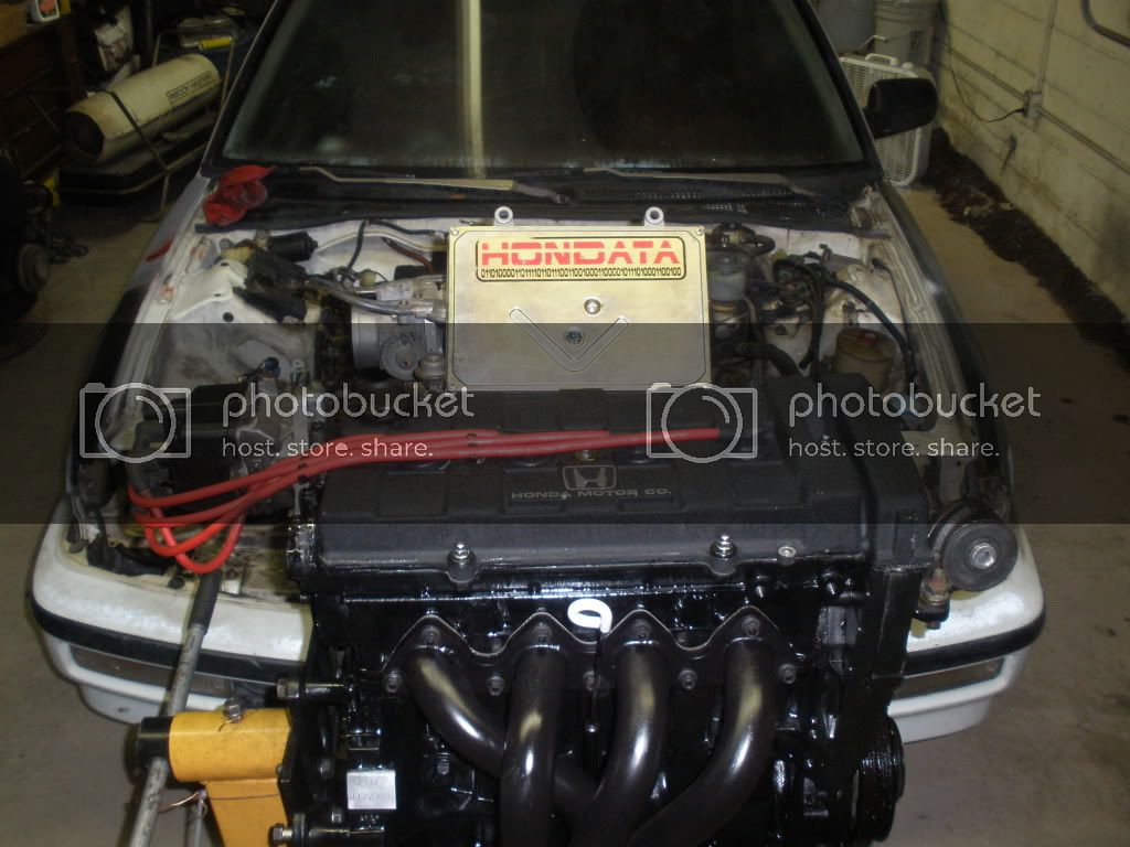

    heres some pic of the m[​IMG]otor let me know what yall think[​IMG][​IMG]

    i wouldnt have painted the block n head black but good luck to your swap man ought to be fun i know my b16 4 door is

    ya paint the block was a bad thing but im not popin the hood for any one so i fig have fun with it. its not a show car and belive it or not all i got in the car is 216.00 dollars thats the car and motor its a cheap build
