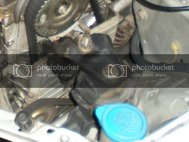

    hi i have a 96 ek i bought with out a motor and tranny i just bought the motor and tranny but its a d15 and when i look online and i see a picture of a 96 ek motor and a 93 ek motor the way the 93 motor goes the motor mounts wont hook up to the chasis like the original one would witch is a d16 please guys i need help im freaking out i really dont know what to do please help thanks

    you are correct, they ARE different.
    the 'ek' mount looks like this:
