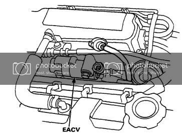

  8. MthaFuknGreen
    3,166
    32
    Oct 1, 2008
    Lodi, CA
    edit: oops..
    thats a pic for the idle screw.. lol
  9. MthaFuknGreen
    3,166
    32
    Oct 1, 2008
    Lodi, CA
    thats on my prelude though..
  10. MthaFuknGreen
    3,166
    32
    Oct 1, 2008
    Lodi, CA
    thats also for fuel injected.
    i have a picture for carburated too..
