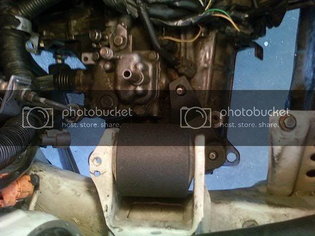

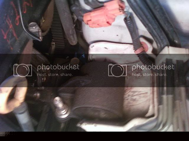

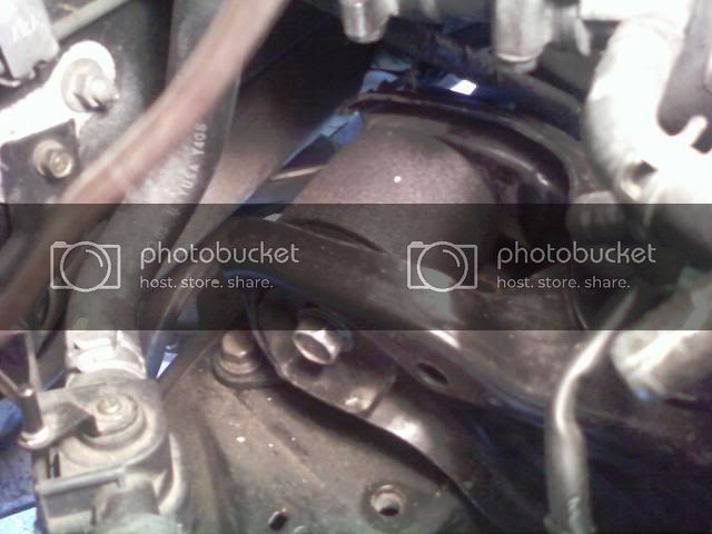

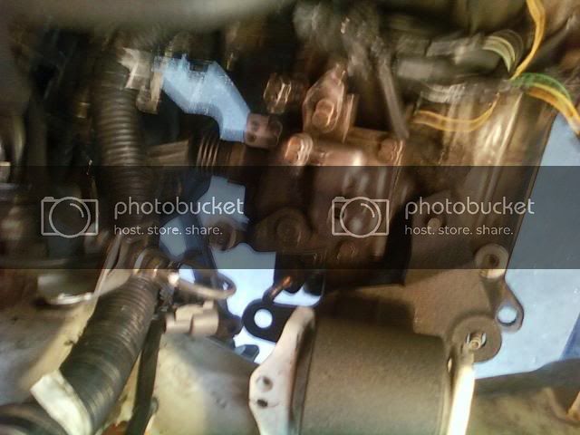

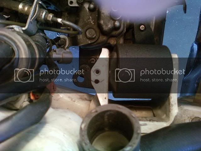

    innovative mount set for the 94 accord with h22a swap.
    It seems the rear mount from innovative isn't as tall as the OEM mount.
    witch makes the engine sit like this \ \ instead of like this | | if your looking at it from the passenger side.
    its making my transmission mount not line up correctly on the trans.
    im wondering if anyone has had this problem or knows of anyone else having this problem?
    it seems spacers may be needed in the rear or maybe because i have the accord bracket and not the prelude bracket.
    any help would be awesome.
    also the two bolt holes on the bottom of the rear bracket where the trans bolts to-had an issue with getting the trans in without hitting the bracket had to loosen all the mounts an beat on the bracket pretty good.
    so i don't know im kinda lost.

    are you sure you got the right mount kit you need a h22 mount kit for a 94 accord, should not have an issue

    yea there was a previous issue that needed to be resolved.
    so i had sent pictures and an email to HAmotorsports,witch is where i got the mount set from
    they confirmed that the mount set was correct.
    i went on my way putting the new motor in.
    but know there seems to be a bigger problem and there is an issue.
    Thanks for you feedback

    i say get a refund and just use the stock accord mounts

    yea the stock mounts where more expensive.only reason i didnt get them.but know i kinda wish i would have...

    Did you contact Innovative? What did they say about it?

    it looks like you have the wrong kit? the rear mount looks as if it used to be a 4 bolt mount (ex) and the new one is a 3 bolt (lx).
