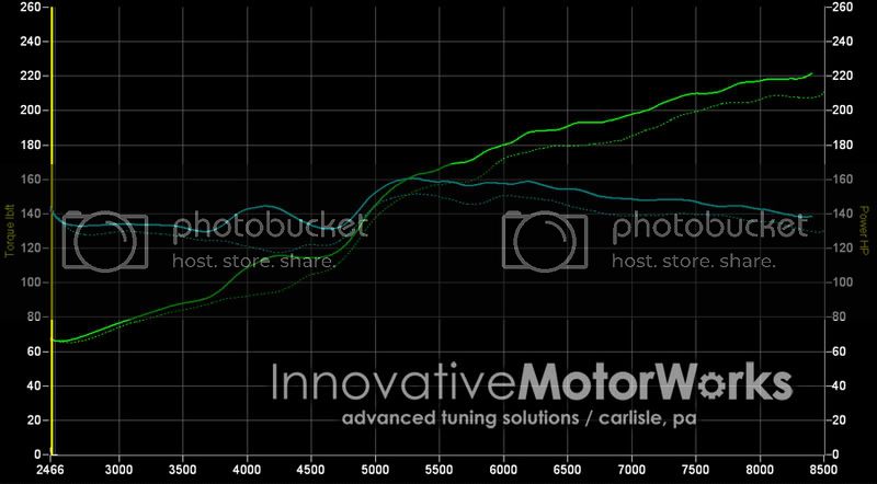

  18. K2e2vin
    K2e2vin Senior Member
    8,442
    92
    Jan 2, 2003
    Raleigh, NC
    Refer to the previous posts. Also, it's not that simple; as stated before the header makes the largest difference; in many instances some notice gains overall with higher gains in certain areas.
    Here's a dyno pulled from H-T(K20A, ref: http://www.honda-tech.com/showthread.php?t=2341715 ):
    Dotted is 2.5", Solid is 3"

  20. phyregod
    phyregod !!YTINASNI
    9,433
    225
    Jun 11, 2005
    Central Texas
    Quoted from the guy that has that posted that sheet:
    This makes good sense.. the header is allowing the pulse effect to take place, along with the first section of the exhaust.. Once the pulse hits the cat, all bets are off, as the cat will kill it.. So from there out, a big gnarly free flowing exhaust would be the right thing to have..
