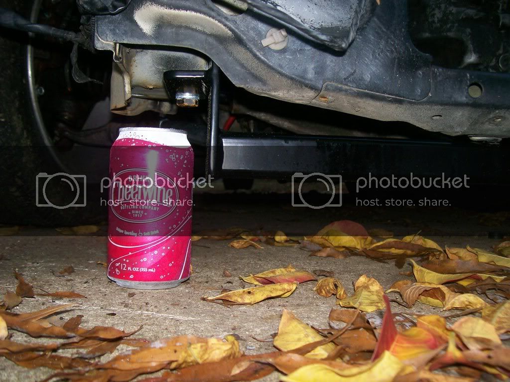

Here's my ESP bar that uses the tow hook mounts and one of the original mounts:
The heim joint is there in place of the big rubber bushings to help the flex of the LCA.
The one I have now is actually pretty beefy; heavier than the Avid and ETD bar I had before. There's nothing wrong with the Innovate bar at all though, plenty of people running them with zero issues. If anything, just avoid the ETD/K-Tuned bar; they have different generations but the one I had didn't even fit right and the components felt "lower quality" than ESP and Avid(Aurora bearings). The Avid bar was only returned due to mfg error(I had pretty much the first or second production 2nd generation bar); it just took too long to fix so I just got the ESP.
