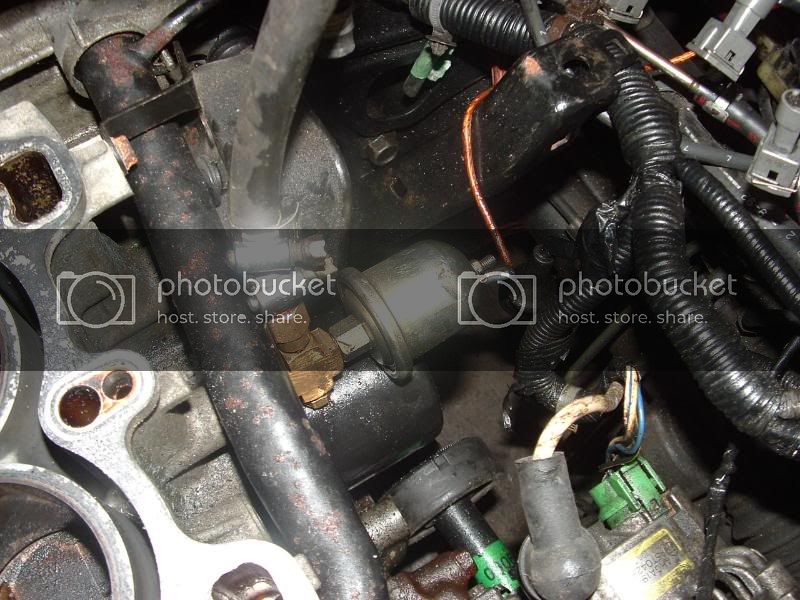

i cant figure out if this is an oil pressure or temp sending unit
does any one know
Looks like a pressure unit to me. Temp senders are normally really small, since all they are is a thermsistor. Best way to find out is to take it off and look at the threading, if it's hollow, it's a pressure. But I'm pretty sure it's pressure.
thanks for the help but bad thing is when i took the damn thing off it broke so now its not doing me any good lol
but once i got it off the threading was hollow
