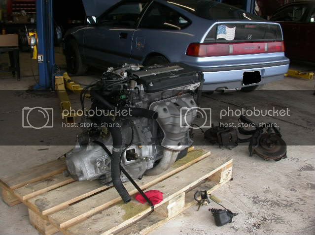

So I decided to go with the JDM B18C, The GSR version. (stuffing it into my 89HF). Got it from Hmotorsonline complete with LSD trans, axles, spindles, brakes, shifter, mounts, a/c bracket, the works all from one place and all the stuff to swap is hasport. Very clean engine. Well packaged and the guy at Hmotors knew his stuff too.:thumbsup:

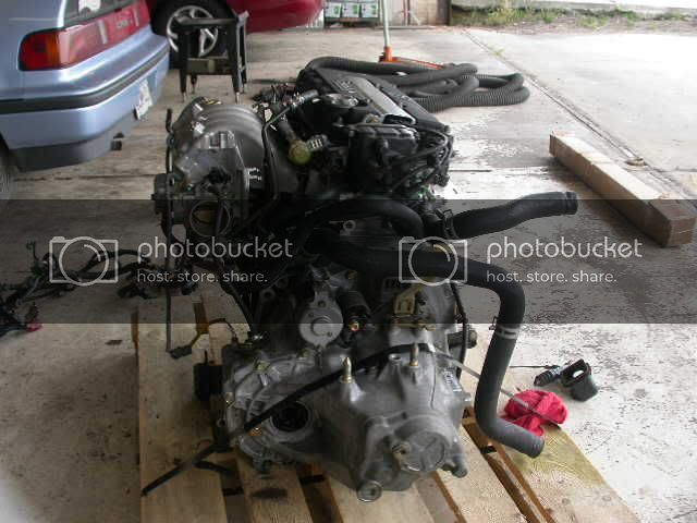

I bought the engine swap complete from Hmotorsonline.com They were great. I got the motor, trans, axles, A/C Bracket, shifter, and cable clutch to hydro tranny adapter too and that stuff was all Hasport.
Enjoy the pics please.

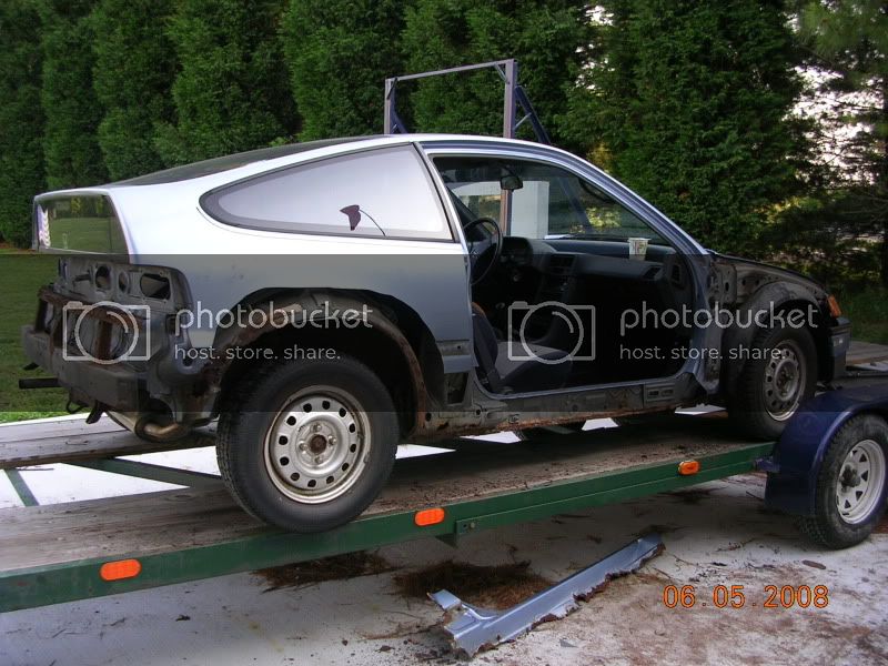

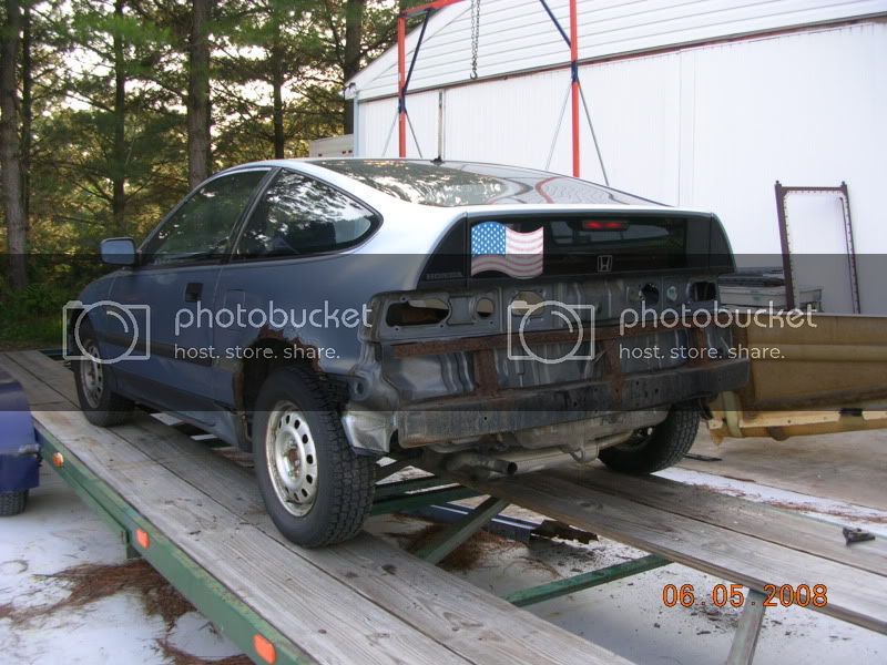

Then They ripped it apart and found way more rust than I thought

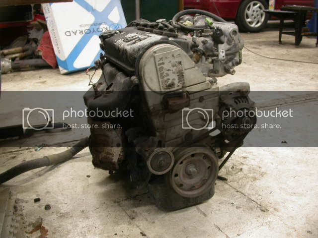

Ol' reliable with 260K Miles
Sweet

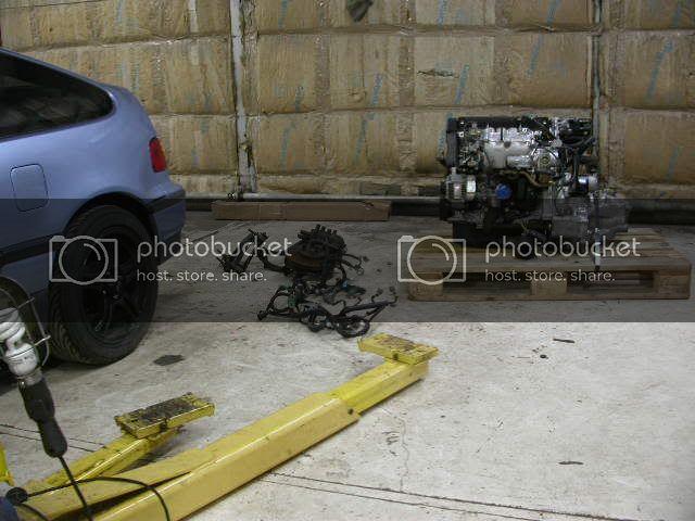

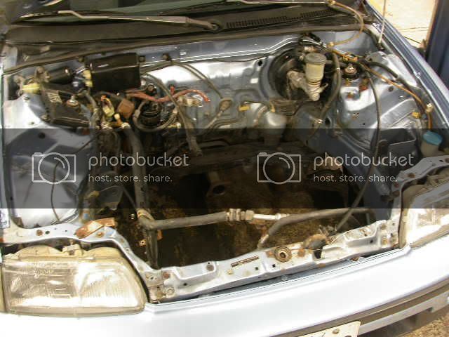

Making one wire harness from the two old ones as per Rywire directions was time consuming cuz I wanted not to go back and do it twice. it worked perfectly right out of the gate with no check engine or driveability issues

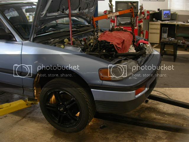

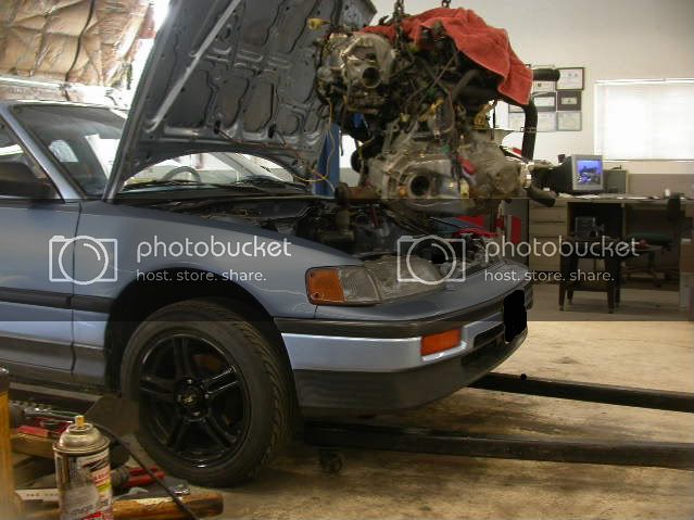

At this point I'm wondering how I'm gonna stuff 1.8 liters of s@!t in a 1.5 liter hole. It was noticeably larger and heavier too.
Slowly, thats how.

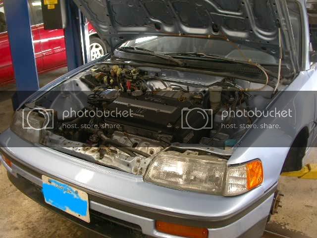

Just another shoehorn away. At this point Im feeling like Wil E Cyote jumping up and down on one of those ACME kits of his. The rear mount bracket goes in DURING the install so I was sliding under the car alot. The lift positioning the car 2 feet off the floor made it easier.
Its in..

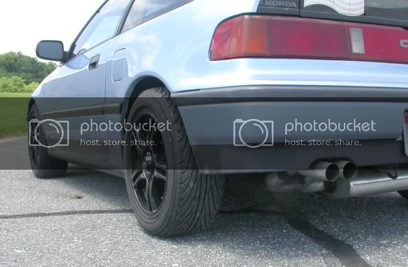

Then new exhaust. Oh BTW, the ol HF system did actually bolt right up to the stock exhaust on the new engine albeit was just barely large enough to cover the gasket. I had to use 2 super long and skinny bolts to do it. It got me to the exhaust shop where they did this

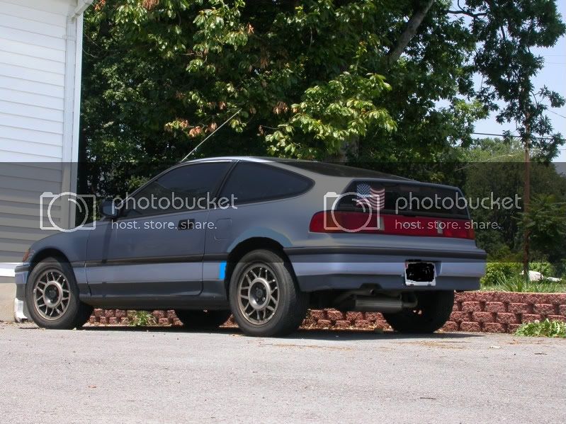

Twin tail pipes on a Walker and a cherry bomb and its still kinda loud. V-tech IS loud
Now for some SERIOUS fun
