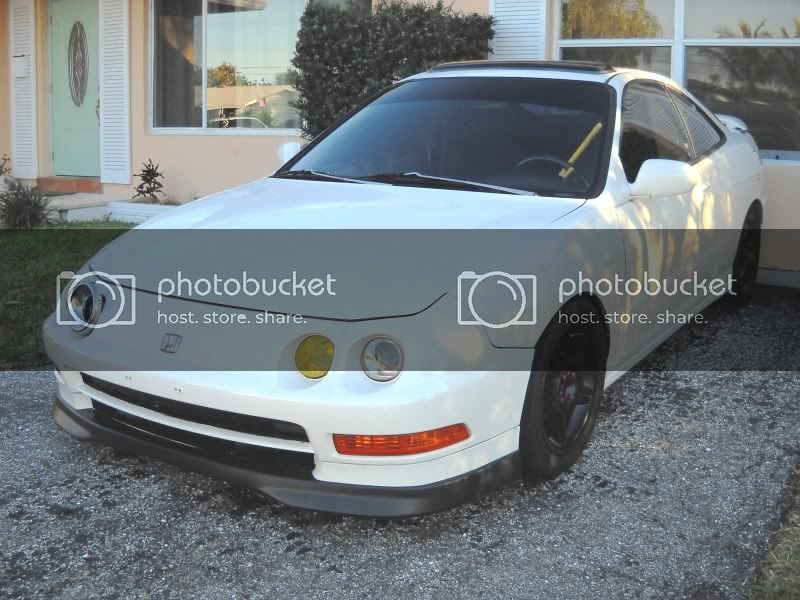

Pics from today.

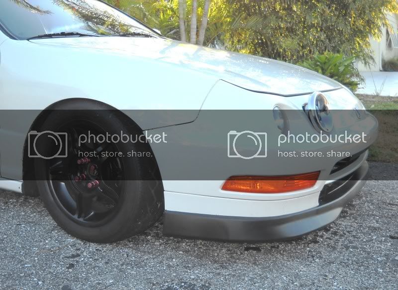

I dont know how exactly street legal it is, but the cops around here dont seem to care. The low beam headlights are still intact and working so at night you cant even tell. I actually just put the velocity stack back on today, I was keeping it a little more low profile with just a black silicone 3"-4" reducer mounted flush. It fits nicely into the headlight hole and looks much more subtle. Ill take pics of it when i put it back on.

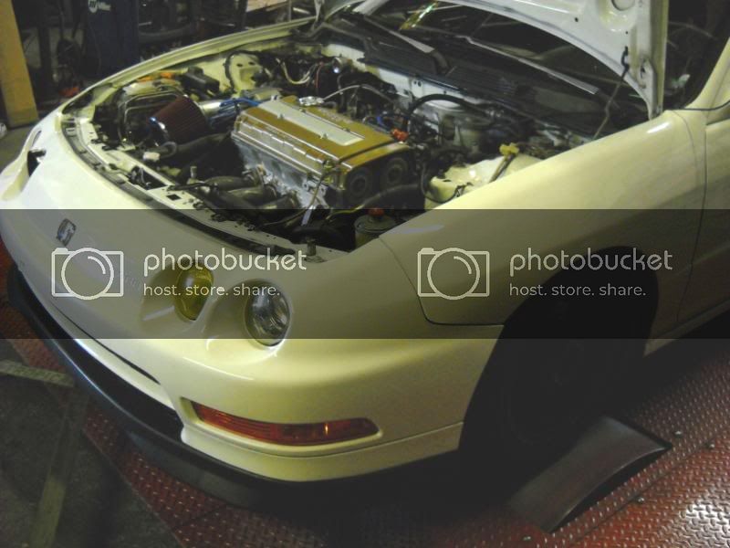

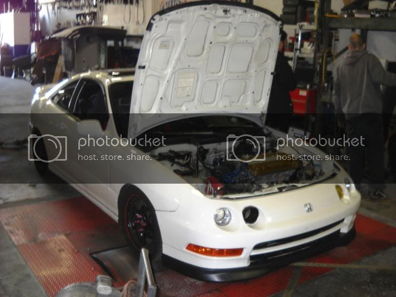

heres a couple pics on the dyno
