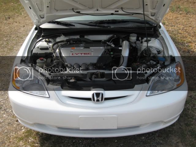

    Ok so I will go ahead and put it out here. I know nothing about these cars. That is why I am here. I do know it's a K20 6 speed manual tranny. It's got disk brakes all the way around(i've heard it's stock with drums in the back):confused:. And it's got the 5 lug conversion. Here is what I am looking for, what kind of performance parts I should be looking for as far as should I be looking for the RSX-S parts for the engine and tranny? The guy says it's got the Acura suspension under it. I couldn't tell you cause I have no idea haha. It's lower with Skunk 2 springs with a nice catback exhaust(crisp sound not so much like a fart can). Also what size brakes should I look for, again should I be looking at the RSX-S stuff if so what year. Unfortunately I don't have any pics of the suspension or brakes at the moment but I do have some to show. Side questions are how much does this engine and tranny swap cost? I paid 9000 for the car and there are no problems with it that I have found except some feathering on the back tires causing a roar haha.
    My last vehicle was a 93 Ford Lightning Pickup truck. I do know a lot about it and the "muscle" car of Ford the Mustang but have no idea on Civics. I know this was a decent deal for a pretty quick car so I just jumped on it. Oh and it's a 2001 Honda Civic EX.

    What kind of performance parts are you thinking of buying? For intake, header, and exhaust, you'll need specially designed parts that are made for that particular swap. For anything else (cams, internals, whatever) you would just buy for whatever car the engine came from...

    9k for that doesn't seem to bad considering older civics with k's go for that a lot.
    however its a heaver chassis, and partly kills the idea of having that engine.
    engine/transmission parts would be from the RSX type S.
    and suspension/brakes you would definitely have to check with the original owner, but I would guess from the acura as well with how it sounds. Perhaps from the EP3 Si, those had disk brakes.

    the k-pro and race header will do wonders for that car, with a good tune you can hit 220whp.
