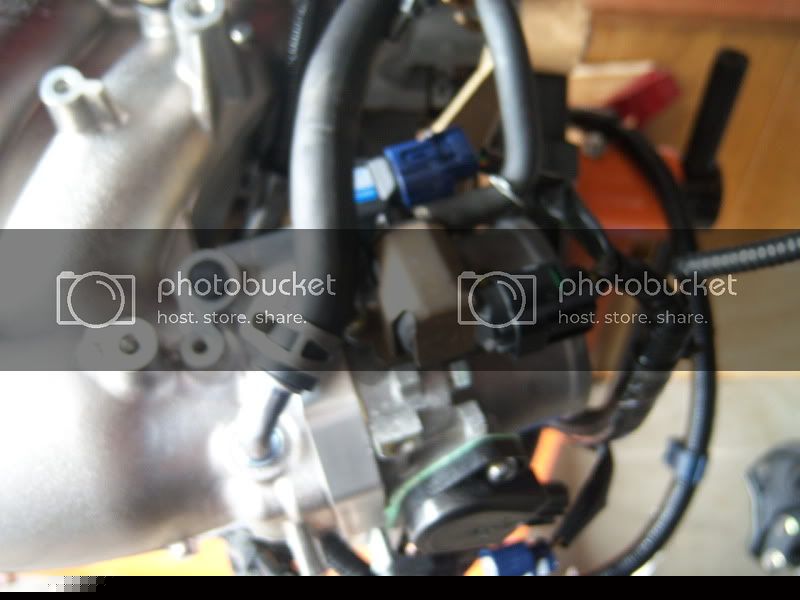

    Here's a RBC (06-10 Civic Si K20Z3) Intake Manifold on my Type R head. It has longer runners and they flow better on top end (esp w/cams/RDX injectors/70mm TB) and I got it online for $198 shipped from a dealer. But you have to run an adapter to fit my Type R TB to the IM and the IACV hoses are too short. Plus the idle air assist tube but its not needed for a swap.
    Here's a pic of the adapter between the Tb and IM
