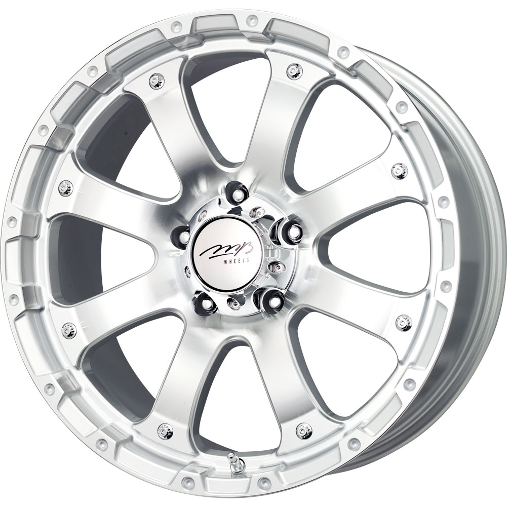

    These go on this week:
    Lightest combo I could find that looked halfway decent and still gave me a fat tread on a 33" tire with a good speed rating.
  5. E_SolSi
    31,985
    5,793
    those should look good on there

    Hope so. Just loaded the wheels into the cab of the truck- hard to do while still in the boxes! I'll toss the tires in the bed in the morning and hope they don't walk away while parked at work, then swing through NTB on the way home to get everything mounted and an alignment package.
    And damn, spent 2 hours replacing 4 damn bolts in the lower control arms so that I have adjustable camber and caster! Geez, took forever...
