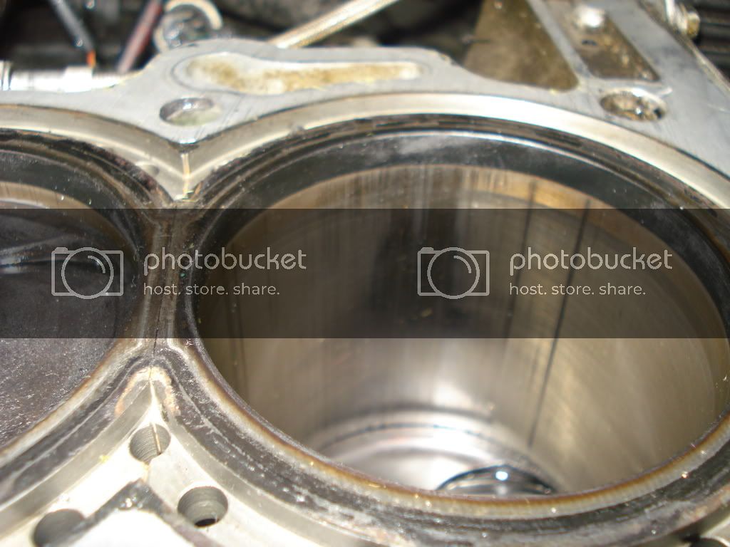

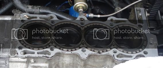

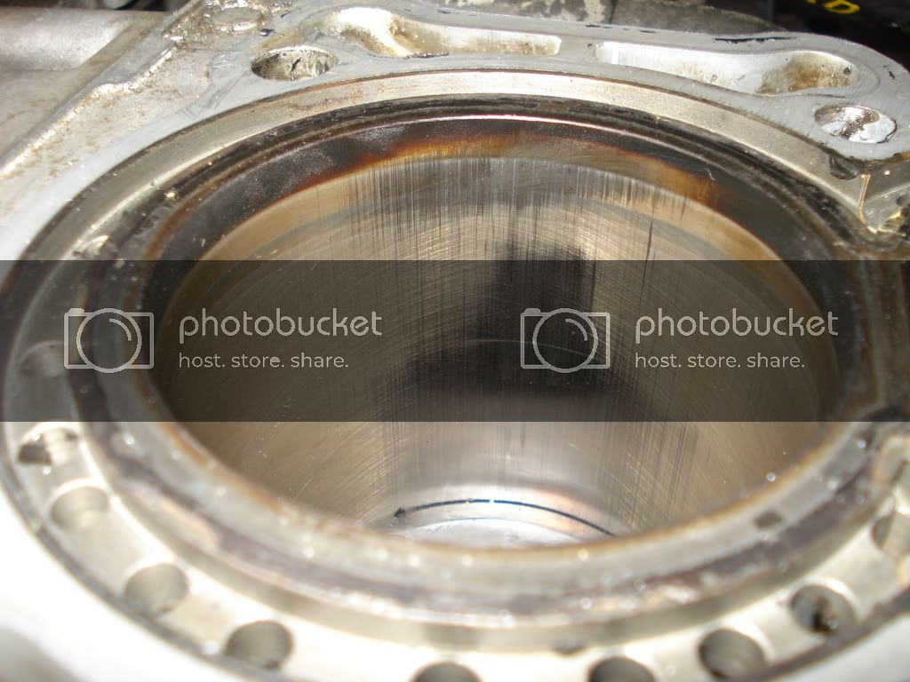

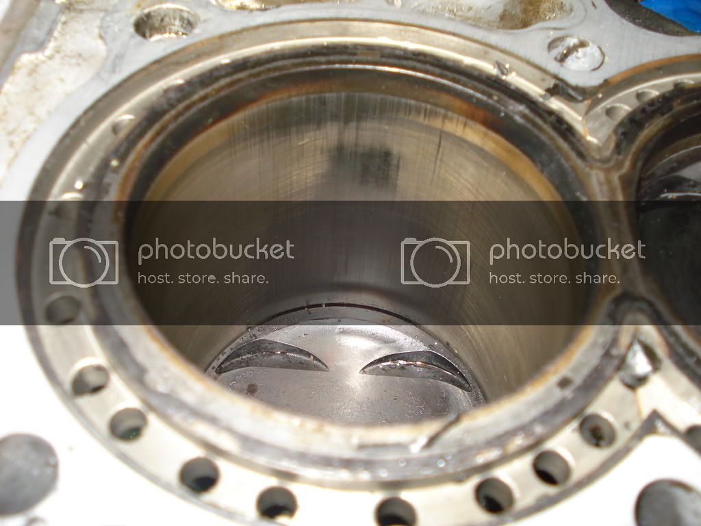

    So after deciding to put a h22 head on the f22, I pulled the head off the car today and saw this.Can you tell me if my sleeves are ok and what would cause the burn marks? I took pics of the worst 2.
    Heres a few pics.
    [​IMG].
    Btw- the block has 9k miles on it since the build. And I can move the pistons about an 1/8 of an inch around the cylinder. I did a compression check before tearing down the motor. All was ok, ranging from 207-210 across.
    All input is welcome.

    I just showed this picture to our mechanic here at work and he thinks that it may be an overheating problem. Is that a block guard that you have on there? If so, I have read that block guards tend to restrict coolant flow, which may or may not explain why your engine may be overheating. That's just his two cents. Let me know what you end up figuring out is wrong with it when you have it checked out or diagnosed elsewhere. Best of luck.

    Nah its not a block guard, they are Darton MID sleeves. The car never, I mean never ran hot. Atleast the temp gauge stayed at normal.

    Did I read that right? I didnt know you could put the H head on the F seires. But what kind of gas were you running in it? They really dont look all that bad though ecept for those hot spots, Ive never really seen anything like that.

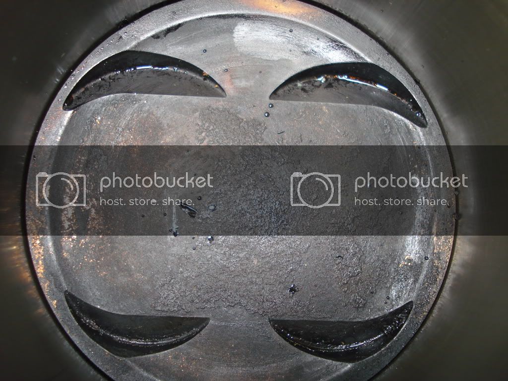

    Back on topic, I have just about got the motor out of the car, and I am leaving town tomorrow morning for work for 2 days and I wont know if my pistons are fucked and if my sleeves are out of round until wednesday night. By the looks of it now, I am going to need bigger pistons/ rings/ rebore/ hone. Might as well go 89mm bore. My pistons will prob look like this.

    did you put the pistons in yourself? It looks like you lined all the rings up when you put the piston in the block, The rings need to be staggered there's a diagram on how they go in the Haynes manual. I don't think you got proper oil flow in there

    The motor was assembled by a Honda tech.

    take the bottom end apart and see if you spun a bearing, something through the pistons off, Is there any wobble in the crank?

    i just got back in town tonight, and I am pulling the motor out tomorrow and starting the disassembly. Something is telling me it was a clearance issue. I should know something by tomorrow. If I have to rebore, I am going 89mm this go round.
