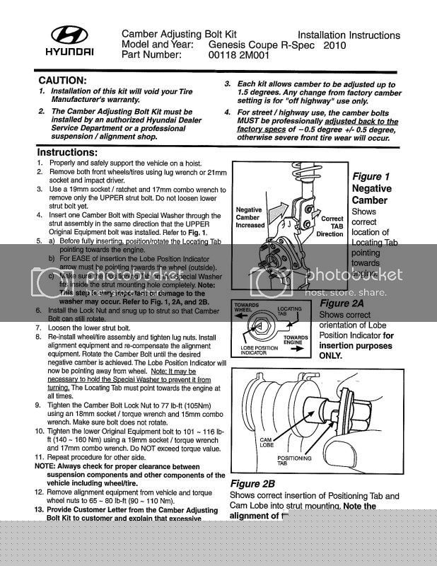

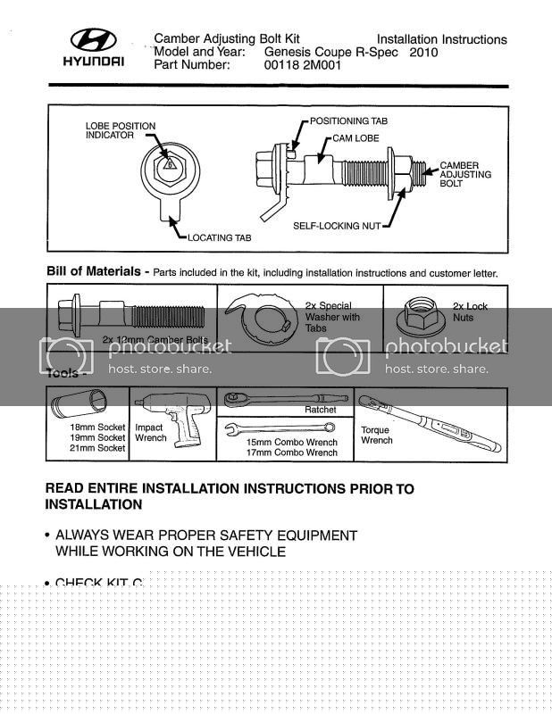

    my car has mac's up front as well.
    To counter it, you just need to run aggressive front camber ALL the time. My car has an optional 'rspec camber bolt kit' to counter it (have, haven't installed). They don't come installed as they void the factory tire warranty and I just haven't gotten around to it yet. Maybe in the spring.
