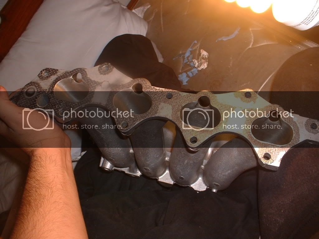

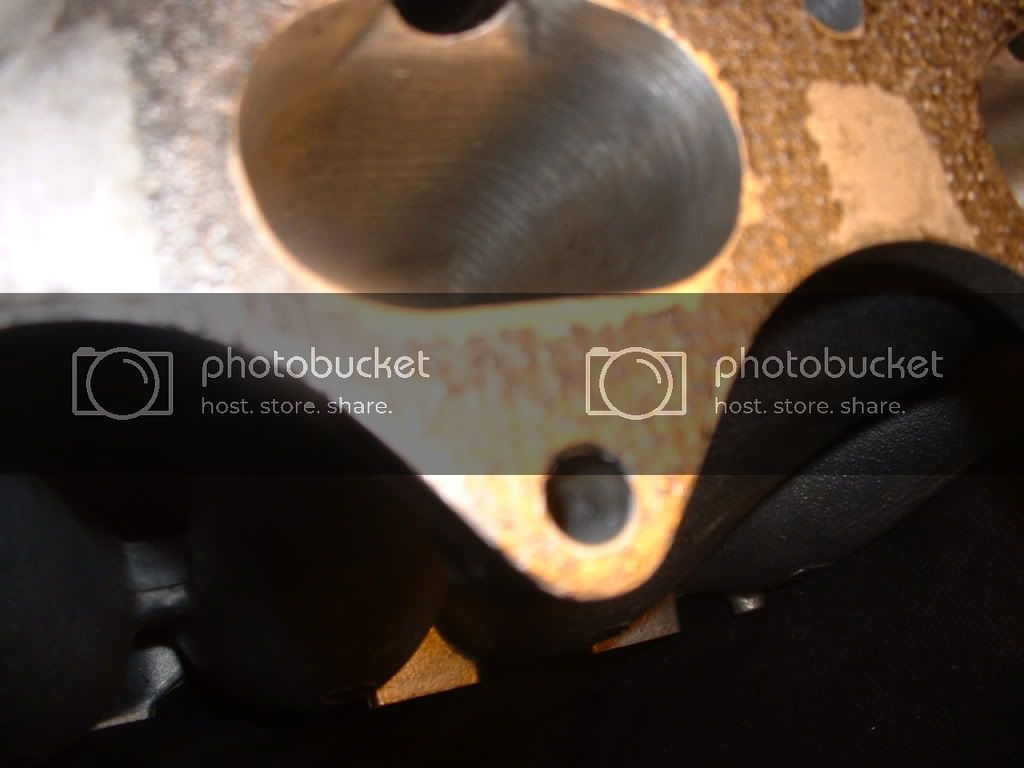

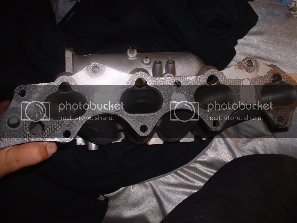

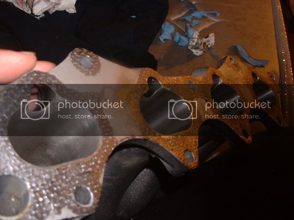

I found my stock LS port and throttle body mached intake manifold!

nice..your gonna have to rematch the gasket..if i was you id run a hondata intake mani gasket..
Yep, Ill do that myself with a micro grinder.
