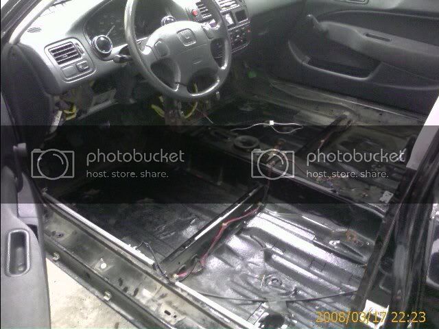

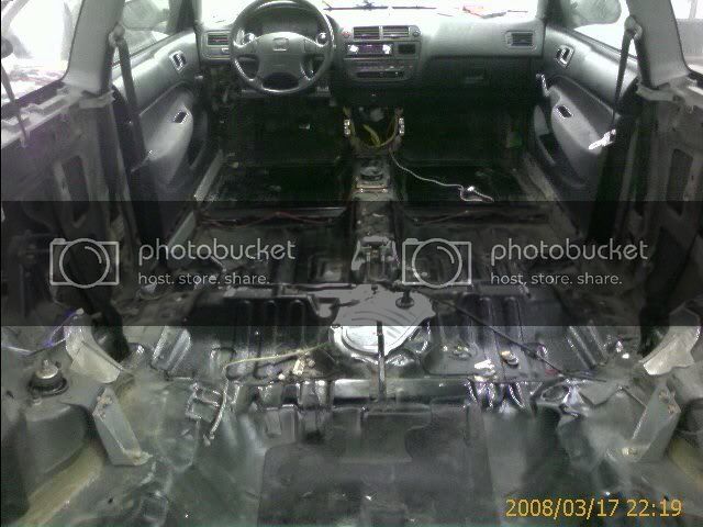

Interior getting stripped, I'm going to be dying the carpet black and hiding alot of wiring.
Another shot of the interior. Not too shabby for 170,000 miles. I found $4.16 in change in here lol.

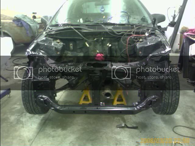

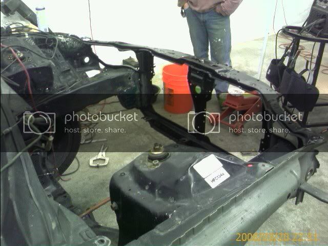

New core support is in place and tacked to the frame. Man, it looks so much better. No more bent up spots and things line up the way they should.
This next pic was a huge problem spot for me. When I first got the car, I smashed into a tree. The tree came right in between the headlight and the grill. It bent the end of the framerail and it really was a pain in the arse to get it back to shape. It's not by any means perfect, but things line up how they should and thats what I wanted. Here's a pic of how it looks now, with the core support tacked up.
And one last pic. Everything sits level, I love it.
A tip for those who are working on changing a core support or plan on doing it in the future: Get everything as level as possible on jackstands or a lift. Also, when putting the new core support on, tack things together first, then hang the body panels and headlights and such to make sure its right. Then go back and do the spot welds.

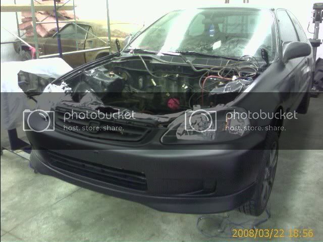

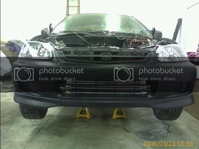

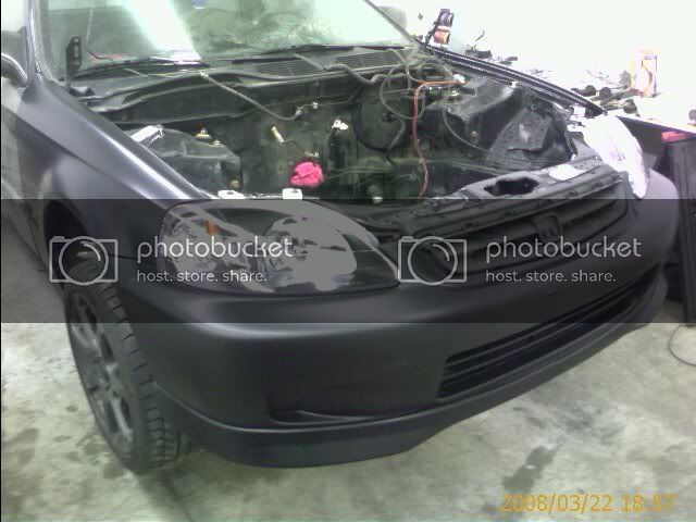

More updates! Tonight's focus was mocking the car up to make sure the core support was in the proper place.
These pics are after several hours of grinding off tack welds and adjusting the position of the core support. It lines up nice now and I LOVE this front end.
MMM FRONT MOUNT GOODNESS!
