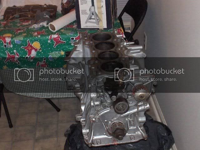

    Stil waiting for parts, but here are some pictures...
    I will be de-glazing it and honing it myself thursday and this weekend the shortblock will be painted black with high temp.

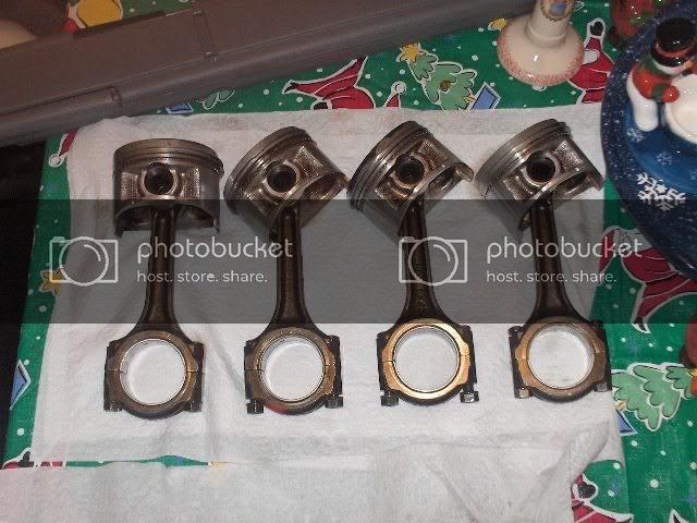

    Here are the old pistons/rods after removal...

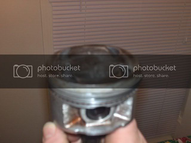

    close up of one of the old pistons..

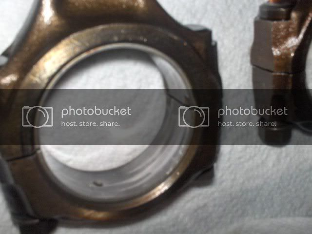

    Here is a shot of the old bearing still on the rod... not looking so pretty i might add...

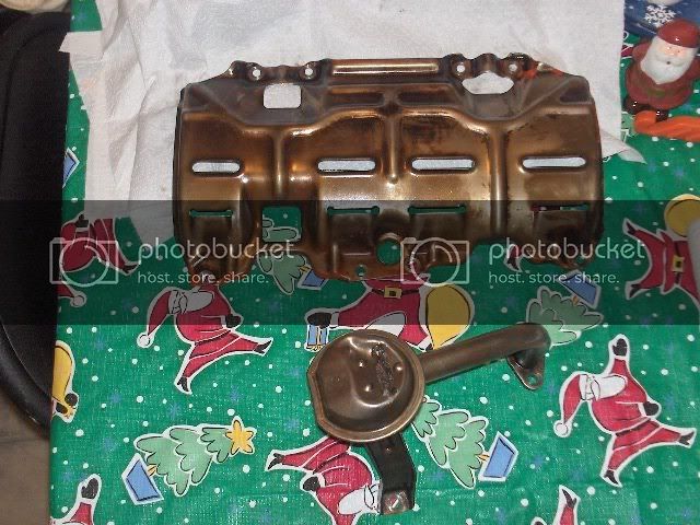

    Here is the windage tray and oil pickup from the LS

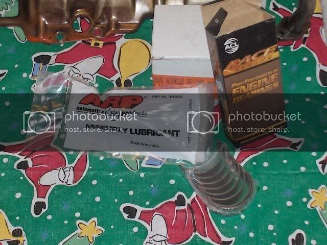

    arp moly lube, acl race (rod bearings), new oem tb tensioner

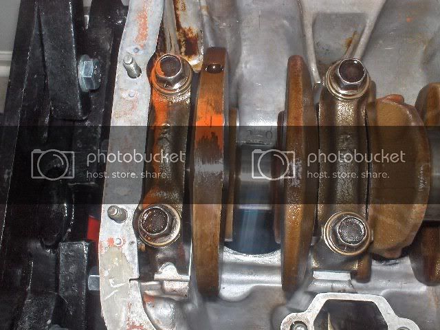

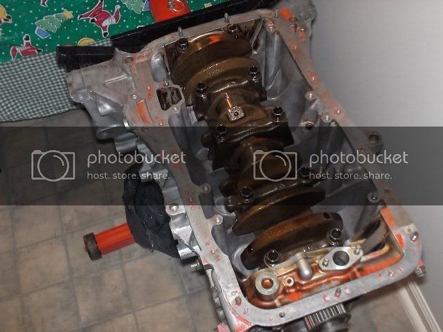

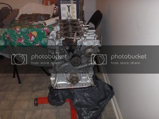

    a couple pictures of the crankshaft still in the block (unmachined)

    What's all that orange crap?
  7. dtob
    dtob New Member
    578
    Mar 18, 2007
    MMmm copper orange. Those bearings actually look pretty good. Mine had some deep scores in them from metal particles.

    That "orange crap" is a sealer the previous owner used to seal the oil pan and did not wait until it dried to form its gasket. he also didnt do the proper job at applying it either as you can see. Your supposed to wait for it to dry before re-installing or else it will end up all over the place.
