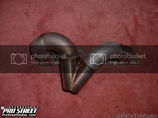

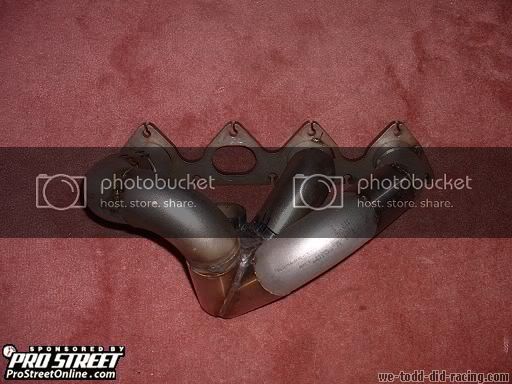

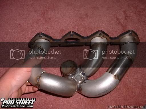

well heres what i whipped up after work. my a/c compatible attempt. its a lil different than what ive seen out.. what do u guys think?/
input would be helpful.
That second runner looks like it might have a small boost leak....
:p
Looks great so far though! Is that going to clear the radiator/condensor?
:p
[post=555708]Quoted post[/post]​
its actually shorter from the flange to farthest pipe than a ramhorn, so itll def fit.
Ok cool. The pictures were just a little deceiving. It's always better to look at it in person.
jsut a bit of observation..
wouldnt you want to take runners 1 and 4 and put them on the closest inlets on the collecter hten 2 and 3 on the farthest collector pipe thing...?
i mean, wouldnt this make it equal length?
just another observation....are u testing these on a block with a turbo of any sorts to see about block clearance and filter placement and , downpipe routing, and all that good stuff?
yes i mock everything up on a car. everything is tested.
