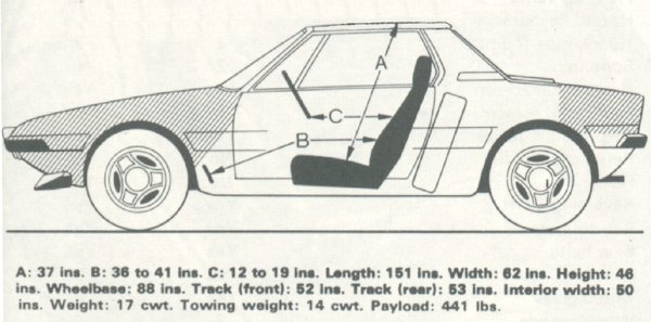

Also, space in the X1/9:
And the car is already mid-engined. pic of the engine bay:
The K20A would probably need new mounts, small stuff, etc. It's transverse just like the stock engine. The F20C on the other hand, would require that engine bay to be extended to fit it and the transmission in there.

After seeing the size of this car, I realize that K2e2vin is right, transverse is the only way you can go. I thought the car was the same size as the porsche. Guess I ASSumed. If you gotta go transverse, In such a TINY car, I would say go B18C, but if you think you can cram an H-series into that micro-machine, go for it.
After further review, I doubt even the B-series will fit in there. You might have to go with a d-series or DOHC ZC.
