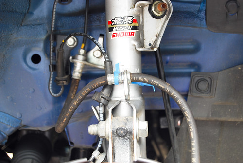

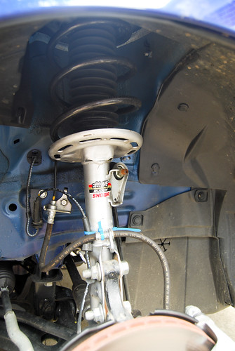

The GD3 Mugen Sport Suspension will fit on the USDM GE8 fit.
There is no hole-drilling required, as the USDM GE8 uses 14mm bolts from the strut housing to the suspension uprights. Aside from the mounting points for the brake line, and the ABS cable, it's a perfect fit.
The strut housing doesn't have the mounting brackets for the ABS and brake line, so you'll have to fabricate something. I used two zipties, one around the strut housing, and one to hold the brake line to the zip tie around the strut housing.
I'll fabricate something more permanent a bit later.

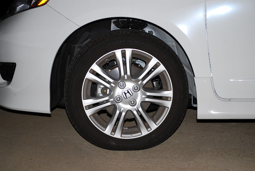

Stock GE8 Sport
Rear
Front

Zip ties have since been corrected with the proper bracket.
Front Left
Different angle

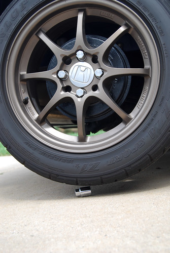

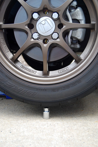

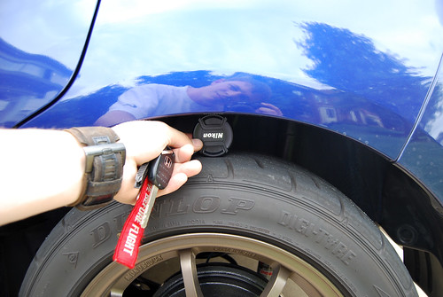

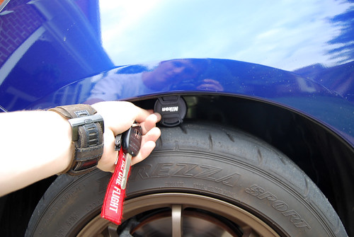

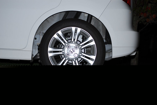

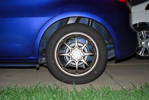

Shots showing wheel gap and ride height:
Front wheel gap:
Rear wheel gap:

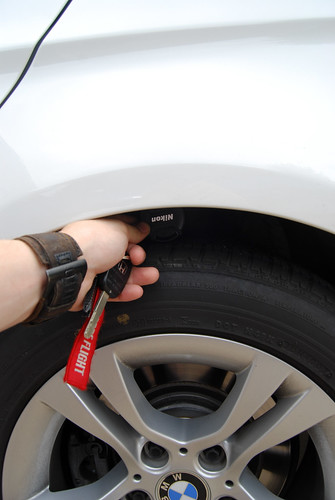

And my mother's BMW to compare rear wheel gap:

The only extra parts you need besides the GD3 Mugen Suspension:
GD3 Brake line brackets
GD3 Brake lines
GD3 End Links (not really needed, but helps maintain the suspension geometry)

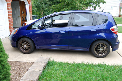

Another update:
The suspension has been performing flawlessly. The ride height isn't bad at all, I don't have to worry about speedbumps or anything. I took the fit to Ocean City, and drove on some really bad roads, I scraped the airdam getting to a gas-station, but nothing else. And I don't drive especially carefully.
I have put about 2k miles on the suspension now, and I have loved every bit of it. The car responds, it hasn't almost gotten out from under me, and I feel in-control. I dn't feel like I'm driving an econobox, just an underpowered car that understeers.
I still need to fix the understeer problem, at the Philly airport Sunday I noticed how bad it understeers. I'm going to try playing with tire pressures a bit again. My track pressures seem to be correct, I just have to get the street pressures fixed.
